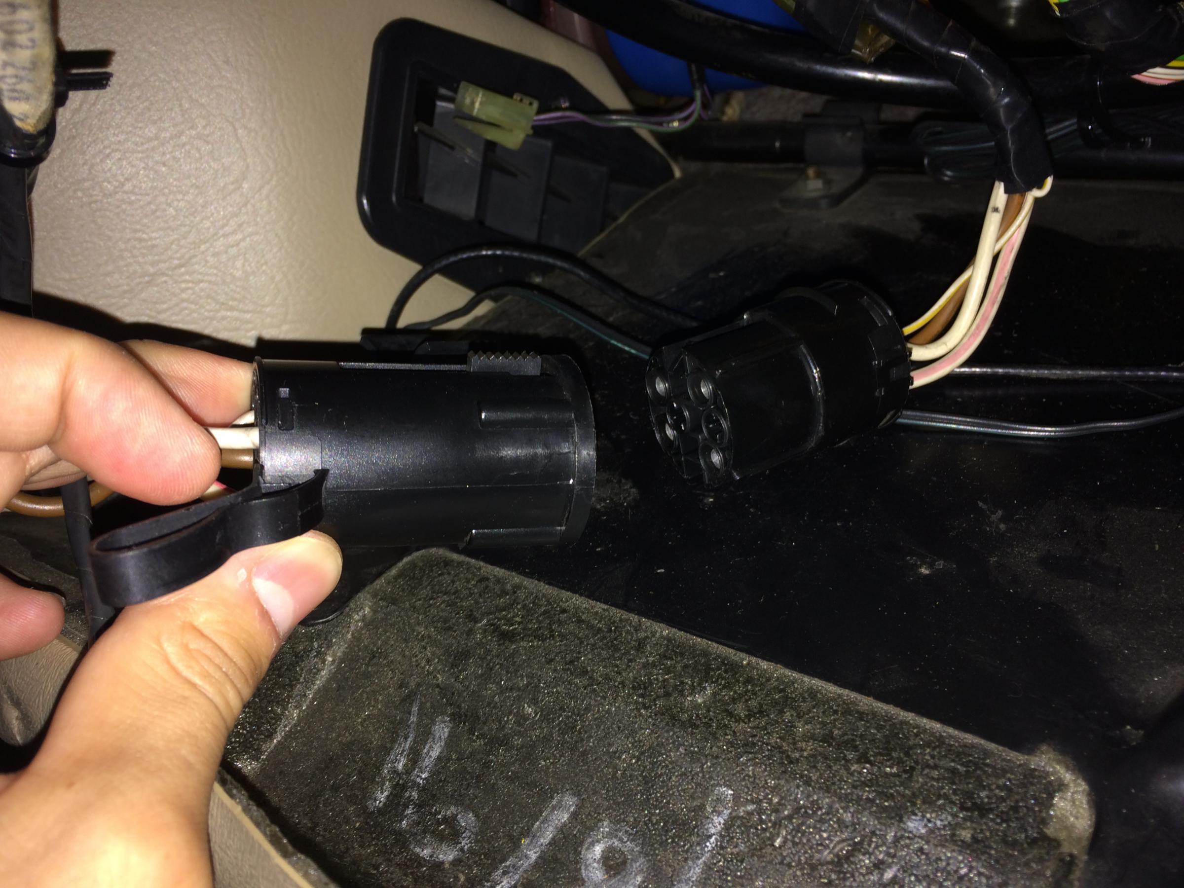

You could check the ignition switch right behind the key cylinder and its connector tied on the steering column.
Mine was the same symptom, and the terminal was burnt in the connector.

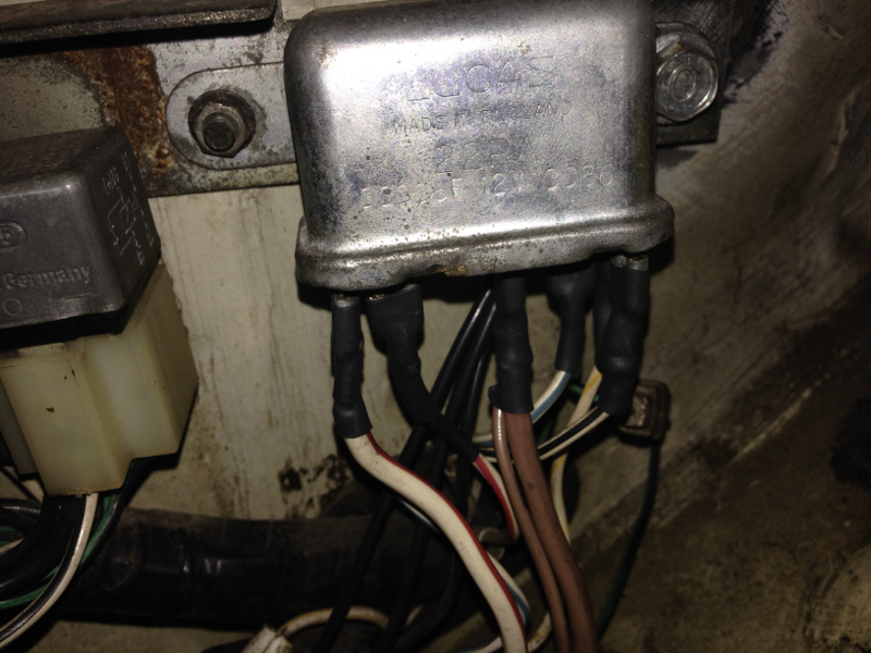

Mine was showing similar behavior (turn key...nothing happens).
I cleaned all the terminals on the starter relay, and replaced all the clips. The original clips were not in good shape and were hard to clean, so chopping them off and soldering new clips on seemed a good idea. I used shrink wrap to insulate them.
This fix has been in place for about 6 weeks and the problem has not repeated itself.

Thanks John. Can you give me a more detailed description of where relay is located?
Old Oct 16, 2014 | 11:34 AM
sidescrollin's Avatar
Joined: Jul 2010
Posts: 2,459
Likes: 695
From: Key West, FL
that is on the RH fender close to the firewall. There is a plastic cover on it

The starter relay is the middle of the three relays which sidescrollin stated.
However, even when the starter is down, you will see the instrument warning lamps when you turn the key. You didn't see them on, did you?
In my case, before I cleaned the terminal it happened sometimes. And when the symptom occurs it was really hard to turn the engine on. Like, turning the key million times then it came on.
I think it was from the oxide film on the terminal sometimes got broken through by the spark.
Finally, the car died while running. It must have been terrifying if I hadn't know about the car. All the instrument lamps were blinking, speedo and taco dancing, then suddenly died.
At the time I was knowing it was from the terminal oxidation, so I cleaned it up. The car was back on the road again and it never happened since then.
It is not a difficult task, all you have to do is open the driver side under cover and check the terminal inside of the big black tubular connector tied to the steering column. I don't think it is not an ineffectual job. At least you can reduce the fear of the symptom like mine.
