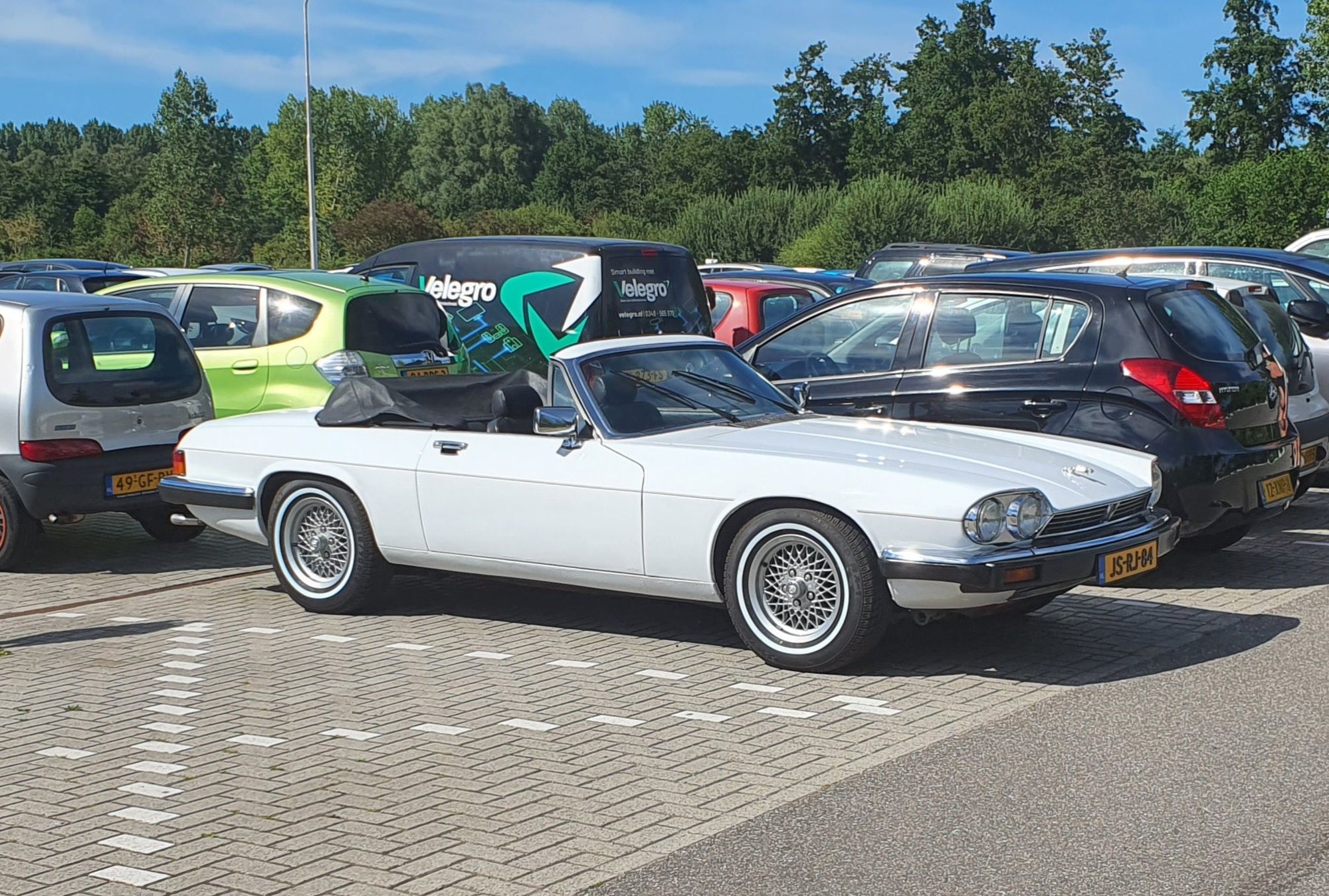

Old Aug 11, 2022 | 02:20 PM
TheDrivingDutchman's Avatar
Joined: Jan 2022
Posts: 31
Likes: 13
From: Gouda, The Netherlands
Originally Posted by TheDrivingDutchman
Thanks for the replies everyone! I'm glad to hear that it comes down to personal preference, and not to one fixed size. Will be ordering soon, first the Lattice wheels need some refurbishment...
I'll keep you posted!
As promised... This is how she looks now. Really happy with the result, thanks again guys!
