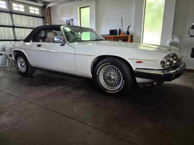

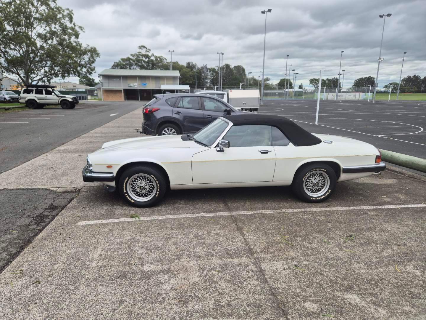

Good evening, Greg, just got off the phone with Grant in sunny SA, we have been discussing ride height, spring size, etc. for the front of the XJ-S. I have just had the front springs replaced using, what I had been told were King springs (Sydney, NSW), and the distance between the front cross member and the ground is 4 inches: too low, as it is supposed to be 6 inches. I have been discussing with Grant what could have possibly gone wrong, and our conclusion is that the springs: a. Aren't King Springs because I checked their web site and they only make the rear ones, and they aren't their signature yellow powder coat: and b. the ones I have had installed are too soft. We came to this conclusion because the car front is too low, and the spring coils are very close together. Notwithstanding, I am going back to the vendor and asking for them to be replaced with the right coils, and Grant is going to give you a call to establish the front coil specs for the V12 HE. Whilst I'm chatting, I used your method of replacing the Rear Engine Mount/Gearbox mount on my Daimler VDP double Six, and it worked a treat. So many thanks for that hack. I will post some pictures on the Classic Saloon section of the forum just to assure members that it isn't difficult to do, and safe. Cheers Chris

Good afternoon all, Received the Berkshire springs and replaced the dodgy ones I was sold by Climax Suspension, Thornton: right size, wrong strength, they were probably a XJ6 spec? Anyway, after another installation fee I now have the Jag at the correct height. Many thanks to Greg, and Grant for your advice and help with sourcing the correct springs, and at a great price. Cheers, Chris
