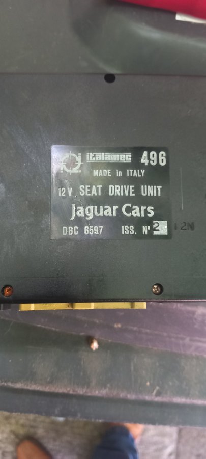

hi
I've just gojuto my seat control module and I think the part number is dbc 6597. I cleaned the contacts but this didn't work. Would you have a replacement please?
All the best,
Zarathushtra

Default Seat Memory Module
Sorry, that doesn't match any of the modules I have.
Are you looking at the module under the seat?
They usually have a TRW number.
Have you checked the controller on the door?

hi,
It's the module underneath the panel just on front of the seat. attached photo with codes I think.

Thanks for the advise. It's definitely the module. I've swopped over and found it to be so.
I might open the faulty module and see if there is anything I can do.
