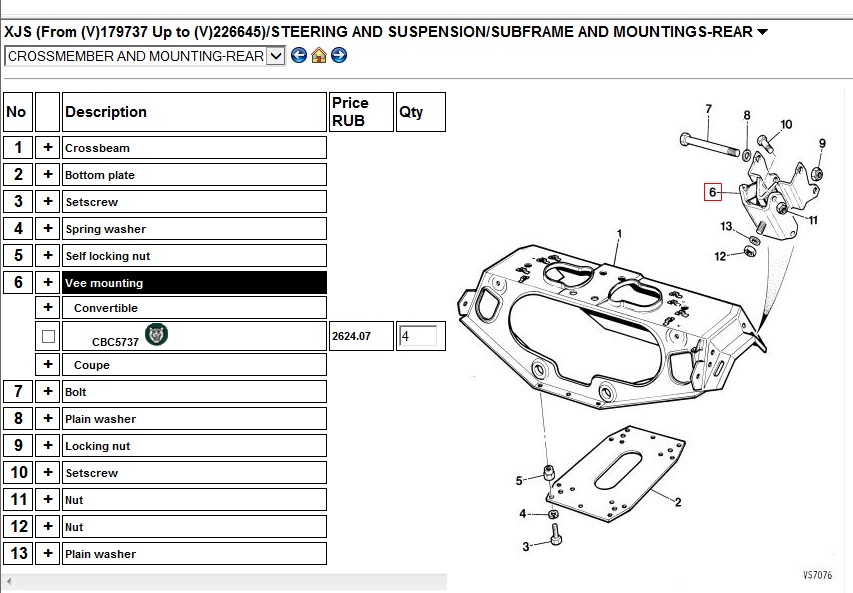

The Vee Mounts (item 6) have de-laminated on every Jaguar I've had with IRS.
I'll be amazed if the ones on your '95 are still the originals.

Thanks for the diagram! Anything untoward about replacing? It looks pretty straightforward. Support from below, undo 8 bolts, lower and replace. Raise and redo all 8. Correct? Anything hidden in there?

The easiest way to replace them is one at a time, this way you can align them easily.
Jack the car and put jack stands under the jacking points, leave the trolley jack under the diff and jack. Start on one side and remove the 8 long bolts that hold the mounts to the body on one side. Then remove one mount only and replace it leaving the bolts and nut loose on the cage, jack that side of the cage back into the car and re-install the 8 bolts then tighten the bolts and nut on the new mount, repeat for the other 3 mounts.
The first time I replaced them I removed all the mounts and it took me ages to get everything lined up so I could get all the bolts in.

They are not identical parts, the 5737 being for the convertible; but I suspect both will actually fit. It will probably be the rubber hardness that is different.
I would not buy anything but actual real Metalastic rubber parts (ie actual OEM-maker parts, even if they are not in a Jaguar box) for the XJS. My hard experience has been any other makes go home very fast indeed.
FYI As well as the two long bolts per mount, there is a small nut that has to be undone to release the locating bit from the cage itself before you can remove the mount.

If removing the rear cage and using the same mounts again, I always undo the long bolts (two each mount) that hold the mount and therefore the cage, to the chassis.
The first time I did it I undid the small locating nut and dropped the cage leaving the mounts in place. Never again, it is really difficult to get them back, whereas he long bolts are easy to reinstall as long as the mounts are not moved. If I was using new mounts, I would do then one at a time as Doug advised, even if I them removed the cage and the new mounts immediately afterwards, it is so much easier that way.
