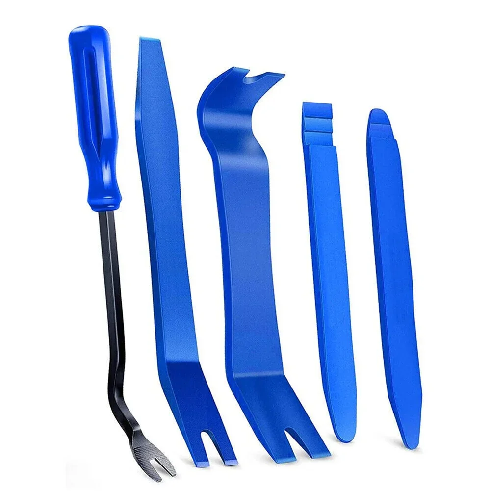

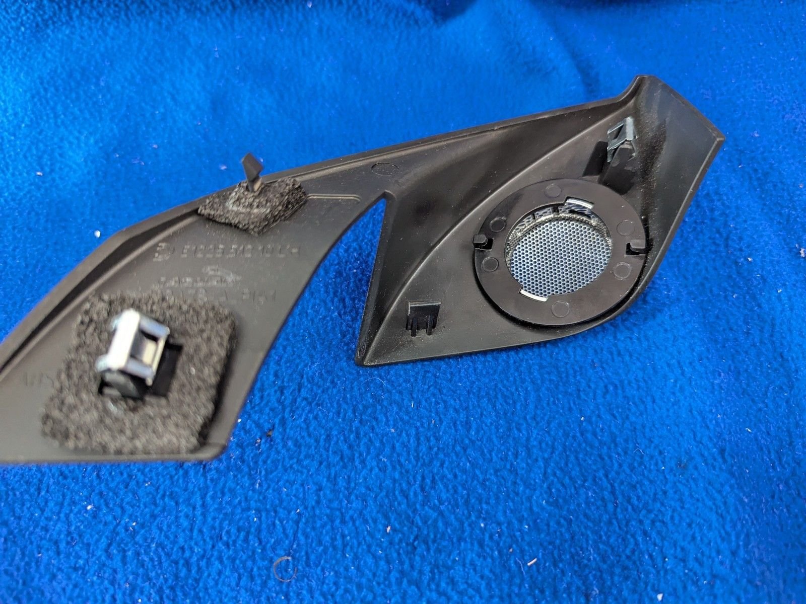

Here's pics of the backside off eBay. Use a good door card removal tool (pic below. The one on far left is good for door cards. Fasters break easy and are cheap. Mounts break are a pain to fix. Note the clips at top of the door they're removed by pulling inward, not up like on many other cars. Pay very close attention to the tweeter. If is breaks, it's $250 for a used replacement.
