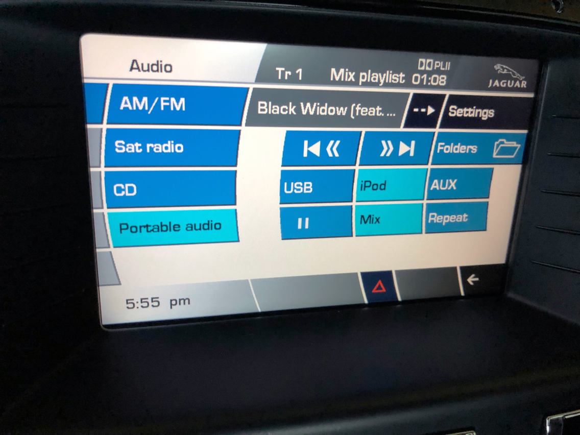

It's pretty simple really, if there is no Sat Radio in the audio menu, it's not fitted.
As mentioned, it can be retrofitted.

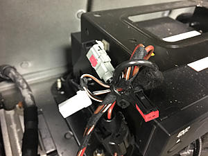

It's possible that the car is pre-wired for Sat Radio, if you check in the side of the media attack in the boot where the Nav DVD drive is, you might find some wiring looks like this;
The red/black 2-pin plug is the power, the grey fakra connector is for the antenna. Ignore the white 2-pin connector that's for the transit relay.
