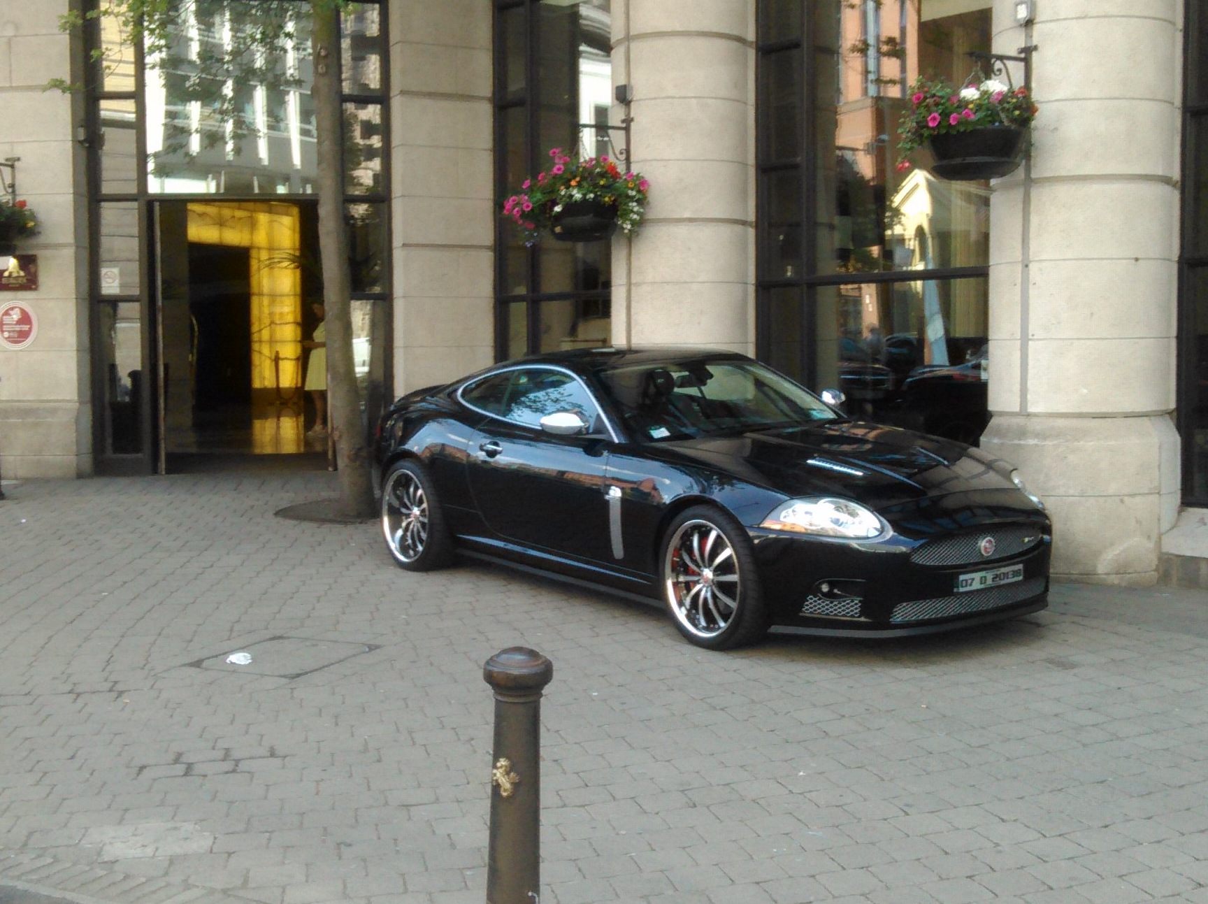

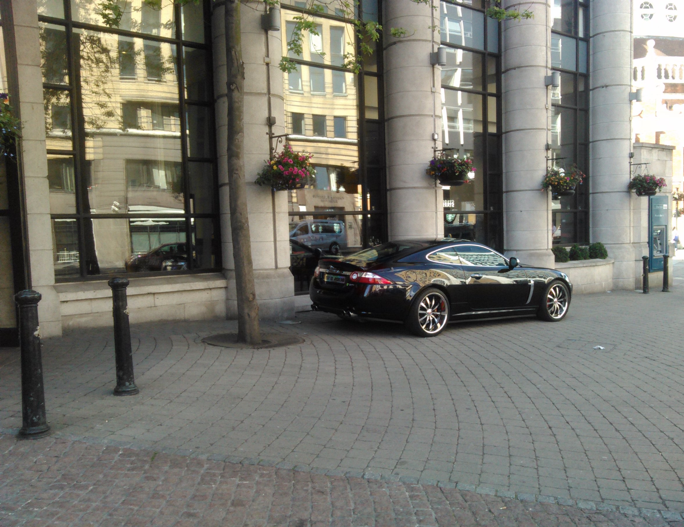

Have mine done around 8 months now and no problems, when i fitted mine got the wheels all re balanced again and the tracking/alignment done, I put 15mm on the rear and 20mm on the front. I went for H&R hubcenterics, best quality i think. No vibration or shudder under braking. Gives the car a better stance and cornering is brilliant.
Attached Thumbnails 20mm H&R Wheels Spacers Front and Rear Initial Review-here.jpg   20mm H&R Wheels Spacers Front and Rear Initial Review-here1.jpg

Mine had the same on the rears, brought them to an engineering shop and got the indents made a bit bigger rather than cut the bolt ends. Then balanced.
