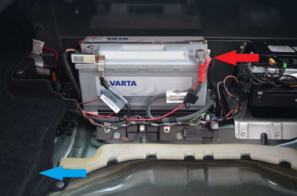

Old Jan 26, 2023 | 01:11 PM
Likes: 17,009
The eyelets on the CTEK flying lead fit the battery positive (arrowed in RED) and the ground stud behind the LH trim (arrowed in BLUE).
I also use a CTEK extension (black and orange - just visible to the left of the battery) to take the connector to the LH rear of the vehicle.

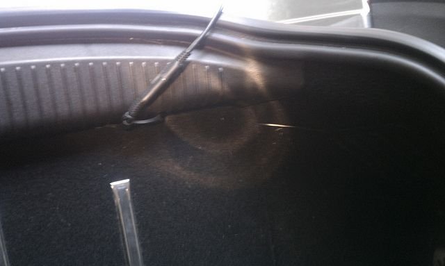

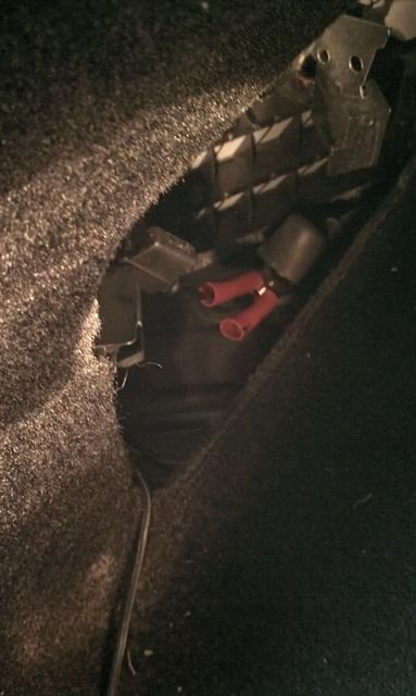

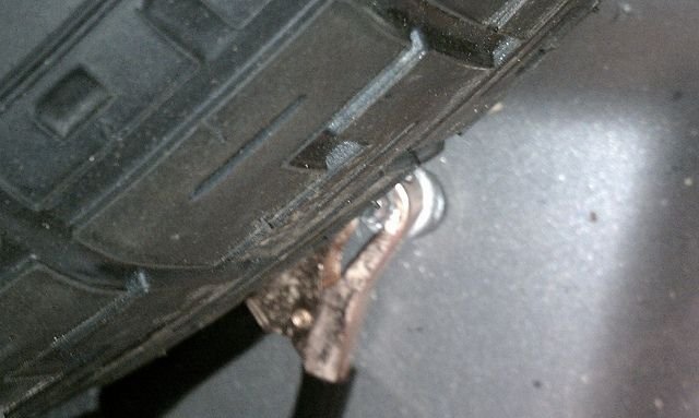

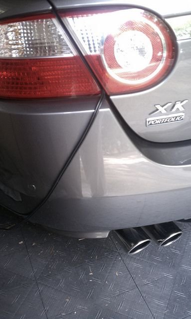

I'm pretty sure that 5.0L owners don't have to attach the positive CTEK eyelet to the positive battery terminal, and can use the CTEK Alligator clips to connect to the positive and negative remote battery terminals in the trunk (boot) like I've done.
The positive remote battery terminal is under this cover on the left side of the trunk on my convertible. Positive alligator clip wire shown under the cover.
Positive remote terminal with alligator clip attached.
Negative alligator clip attached to remote negative battery terminal in rear center of spare tire compartment.
Wire going from trunk to battery maintainer.
Wire to battery maintainer.
Old Jan 27, 2023 | 03:01 AM
JonWat's Avatar
Joined: Dec 2012
Posts: 402
Likes: 99
From: Swansea, Wales
That's what I've done on my 2014 except I used a bracket behind the panel as an earth as all earths are the same.
Old Jan 27, 2023 | 03:46 AM
Likes: 17,009
I'm pretty sure that 5.0L owners don't have to attach the positive CTEK eyelet to the positive battery terminal, and can use the CTEK Alligator clips to connect to the positive and negative remote battery terminals in the trunk (boot) like I've done. ......
Stuart,

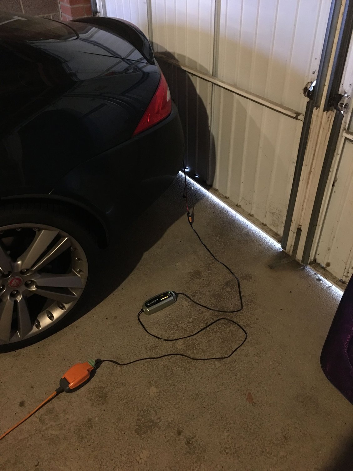

The Alligator clips are considered a 'soft' (temporary) connection whereas the Eyelets are a 'hard' (permanent) connection.
My CTEK 3 metre extension exits through the same LH vent grille as yours and is long enough to connect the the CTEK on the garage floor. The luggage compartment lid can safely be closed on the extension lead without any damage and coils up in the luggage compartment when not in use.

Basically I do the same as Graham. The only difference being I have the C-Teck mounted on my work bench. That way, if I forget, which I have done once I only ruin the cord which is easy to replace instead of running over the C-Teck.

My present 'on the floor' CTEK location is only temporary and definitely NOT recommended!
We recently moved home for the first time in over forty years so a wall bracket is in a lowly position on a very long priority list.
