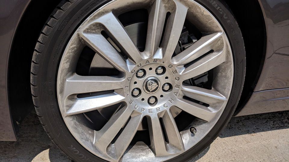

Dunno, man. I put some Porterfield R4-S pads on the front of mine about 100 miles ago and cleaned my wheels at that time.
This is what I have now, but they DO stop well:
I hope this mess if from bedding the pads in, and will decrease the longer I use them.

The R4-S is a performance pad (nice choice Cee Jay) as is EBC YellowStuff, and performance pads will always dust.
Ceramic is a mid-grade, low dust option at best, and that's the trade off you need to think about.

Cee Jay, the dust will get better. They wont be as low as Akebono but a big improvement over stock and they will stop fast repeatedly.
