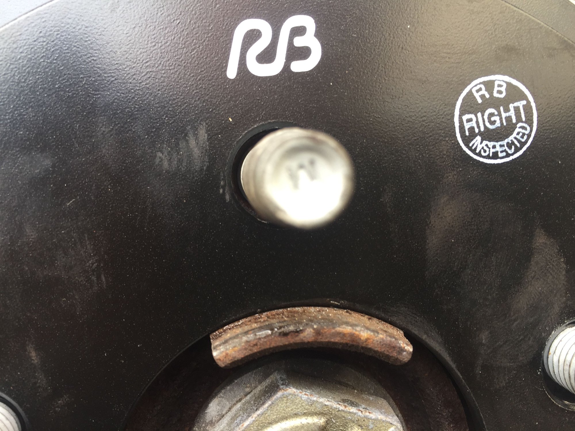

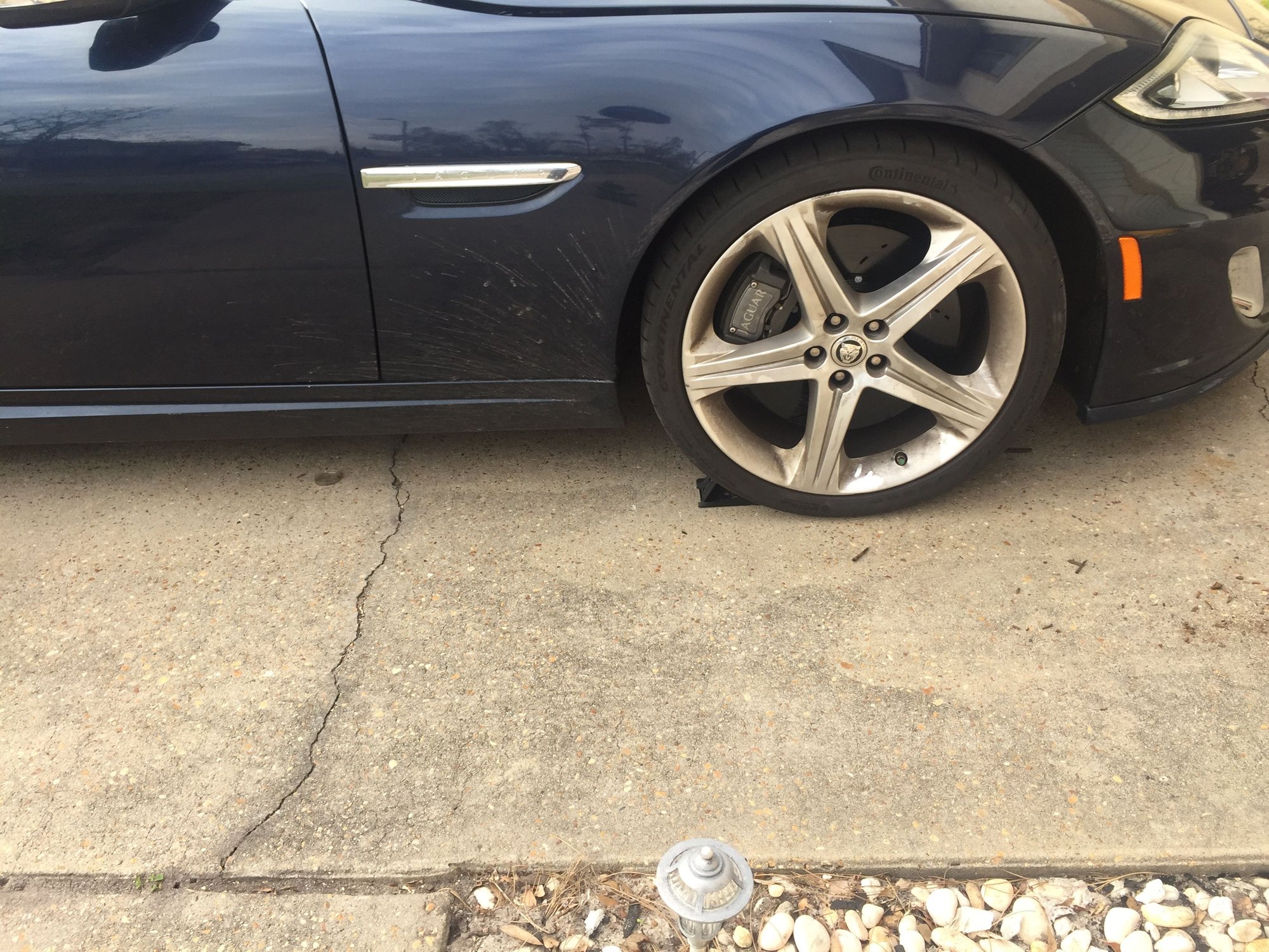

Ok so. I am a new member but long time Jaguar owner ( 88Xj6, 95Xj12, 05Xkr, 14Xkr ) and forum follower to which I owe many Thank You! to All of you who post on here You have been such a great help through out the years.
So here is my first contribution. A brake upgrade Mod. specifically to the rotors to my 2014 MY. XKR.. I really like the looks of the X150 but what surprises me every time is how many more compliments it gets over my previous 05XKR. So here we go . Fist and foremost I have absolutely No affiliation with the company https://www.racingbrake.com by chance during an extensive search on the net I came across stated company, they only sold Jaguar upgraded /racing rotors for the XF , however after verifying the sizes through Jaguar part/s number look ups showed that the XKR ( ATI ) rotors are the same . Since the front rotors made the greater difference in weight, and performance I ordered them first. After about 3 months of driving ,and finding the quality to be very! good I decided to order the rear set of rotors, although not having the weight savings of the front they do have a more greater visual impact than the O.E.M.s .. So here are the pics (at Mums house ) they speak for themselves.
The initial price is Not cheap however after driving ( as I normally spirited do) for ~ 5 months ( 6,230 Mi. ) on the front ones the only wear I could gauge is the lack of the original black paint to the rotor surface. However having spoken with www.racingbrake.com ( Not easy to do but they did eventually call me back ) the rotor material is of a higher Brinell # and should last more than 2X the OEM rotor life. ( yes that mean they will wear the pads more ) so far I have not found their claims to be bogus if they last 2X longer than OEM then its an even better deal.
All in all; does the car look better ? YES!., Does it brake better ? Yes a bit ( that is because Jag brakes are already Very Very good to begin with )., Does it accelerate faster ?. Well my butt dyno cannot tell, but by Physics it should., Does it handle better?. Yes less steering wheel kickback when doing jerky/quick turns., Is the front end as bumpy as before when going over I& potholes ? No . It actually improved the ride. Do the vent slots fill up with pad material thereby becoming useless? No . not that Ive seen so far, they apparently either through wind or rain are self cleaning. All in all a good upgrade, and Im very pleased its well worth the money for me , as for you well that is you r money so your choice.

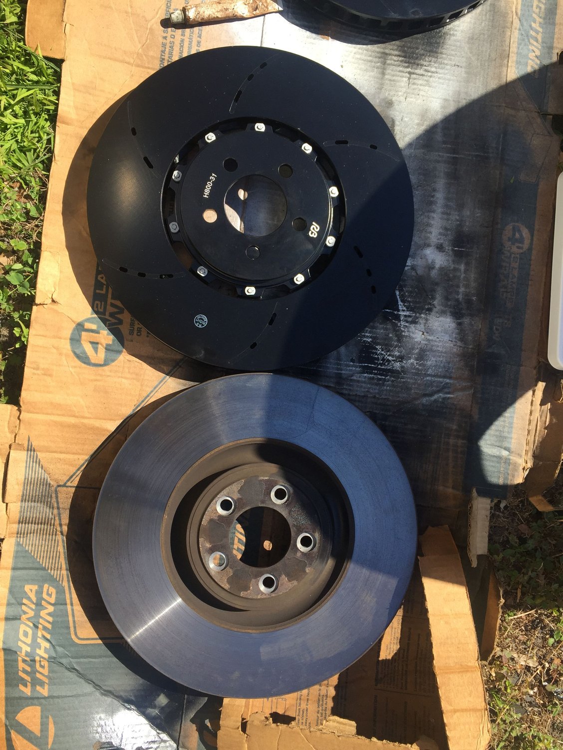

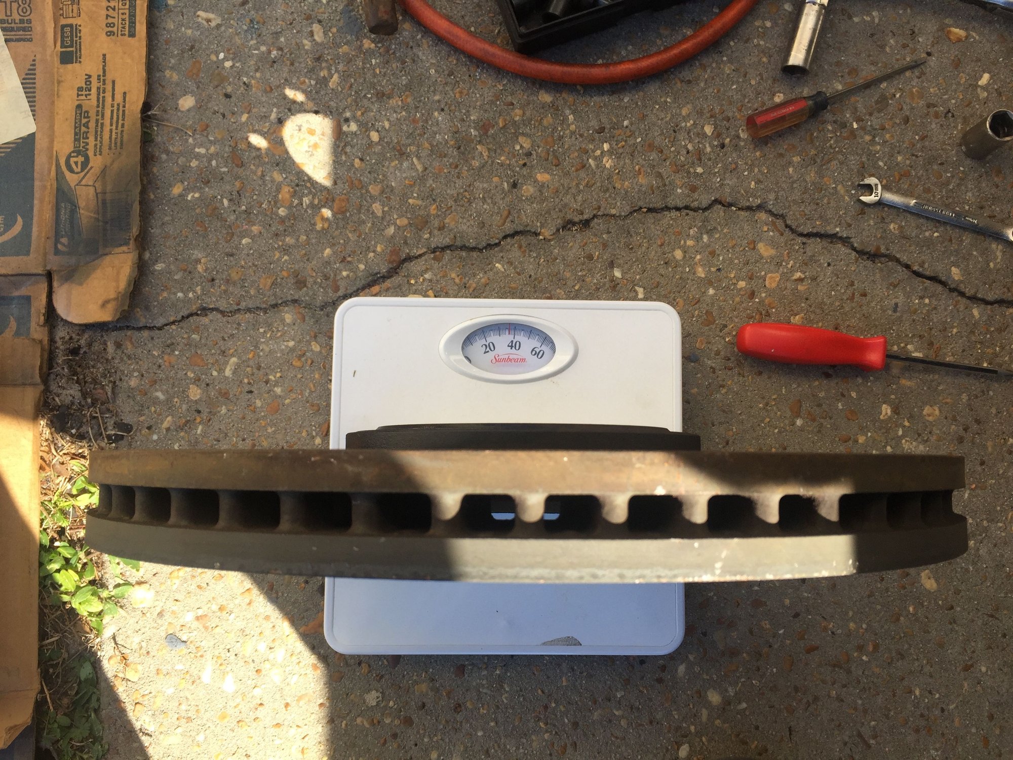

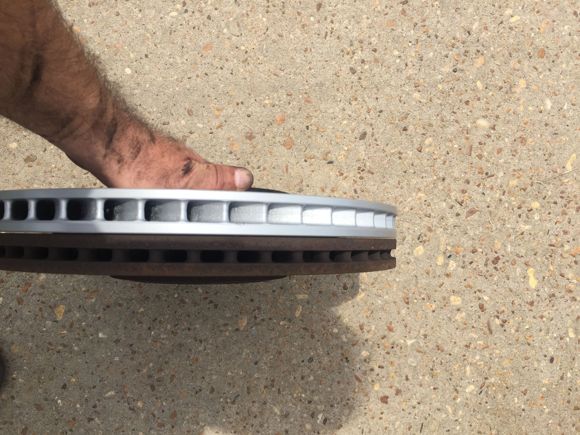

Original OEM. note the weight reading on the scale , and compare it to the https://www.racingbrake.com rotor
New rotor weight saving as advertised. The scale was 0'd ( zeroed ) each time.

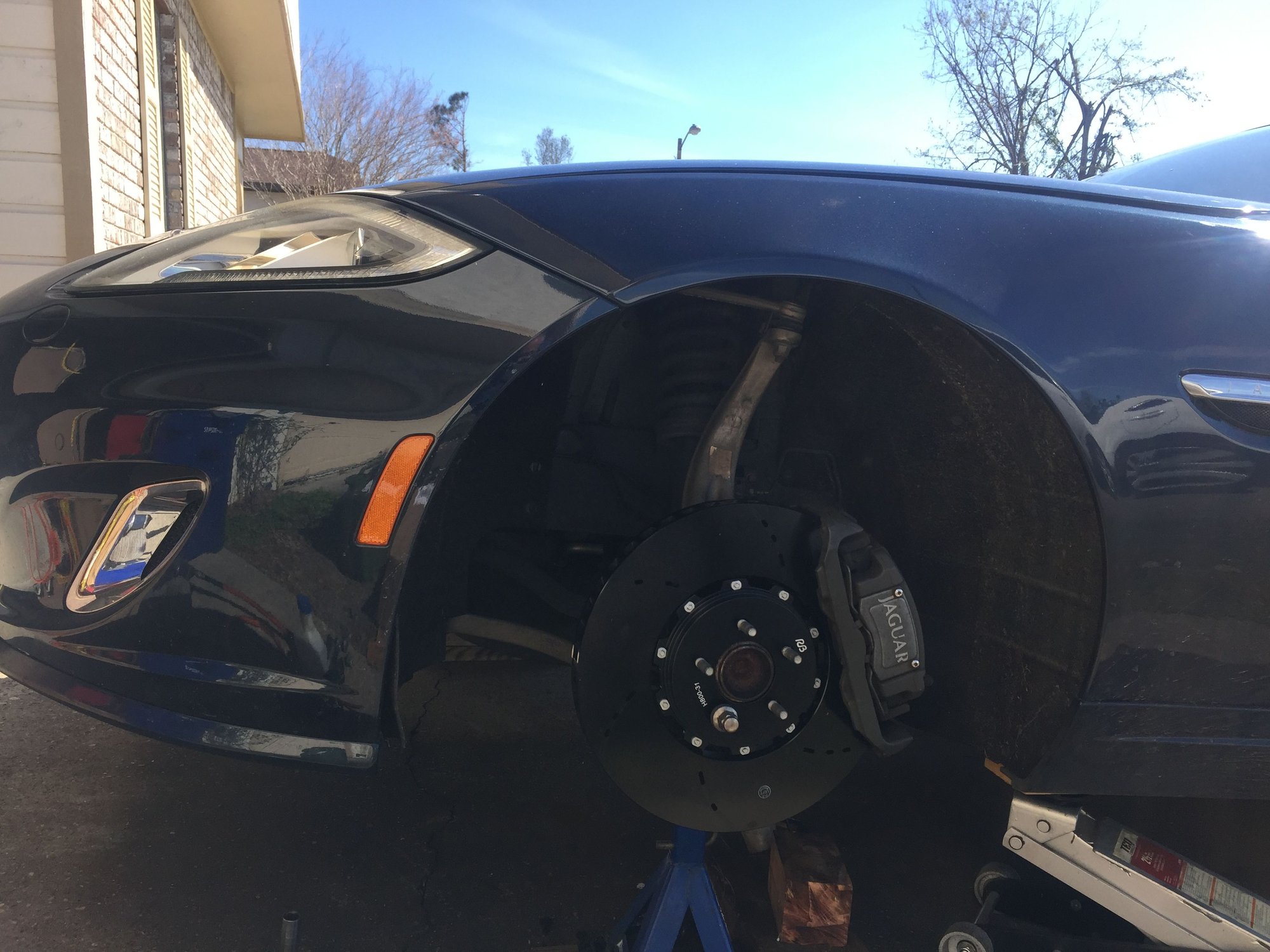

Note that the slots on the new rotor are Not just cuts on the surface with then fill up and become useless, but these go through the rotor itself on both sides.

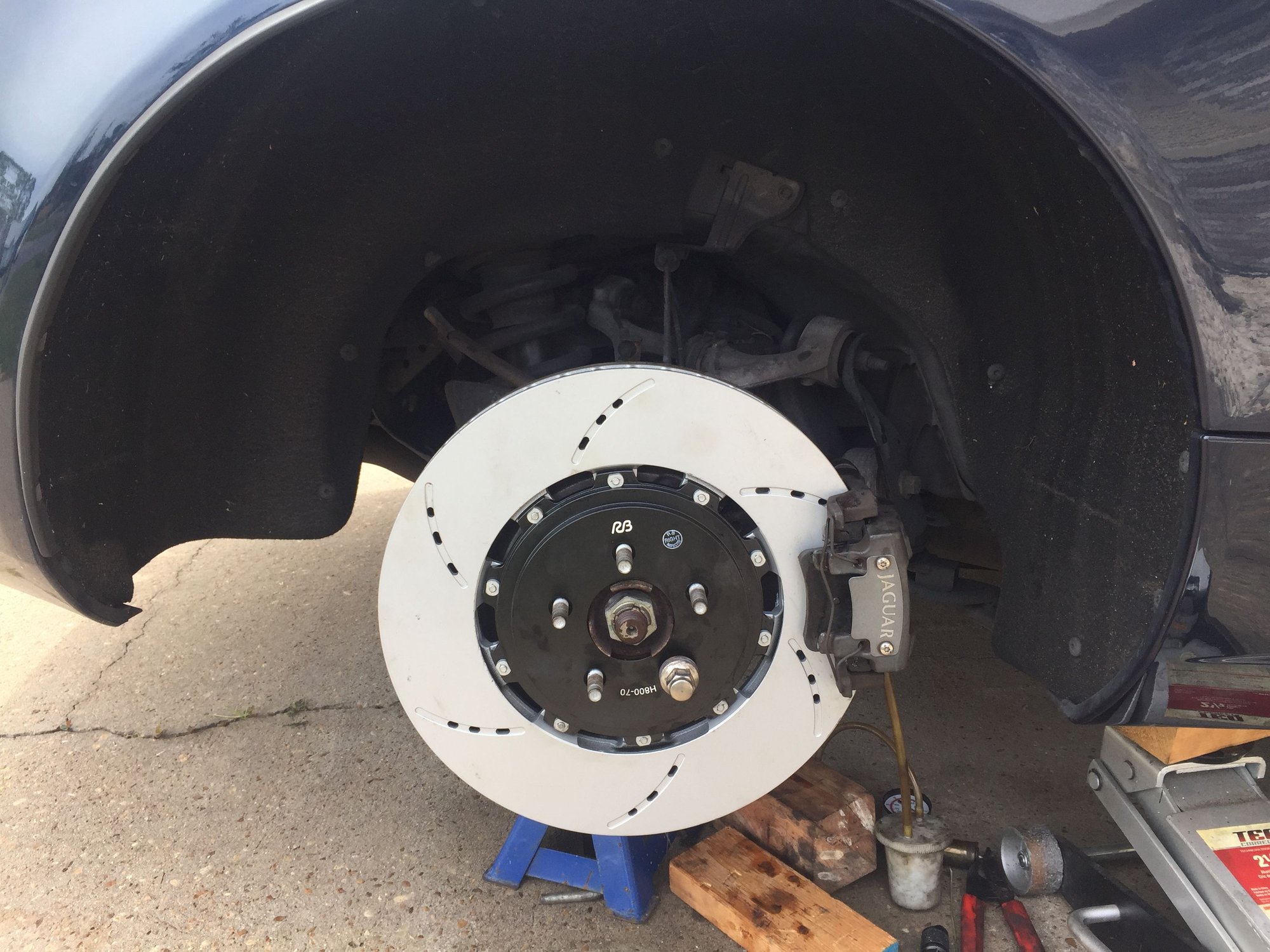

Driver side.
the rotors are labeled ,and are properly mounted to the correct side.
Looks good.
Cuts do go through as they should.

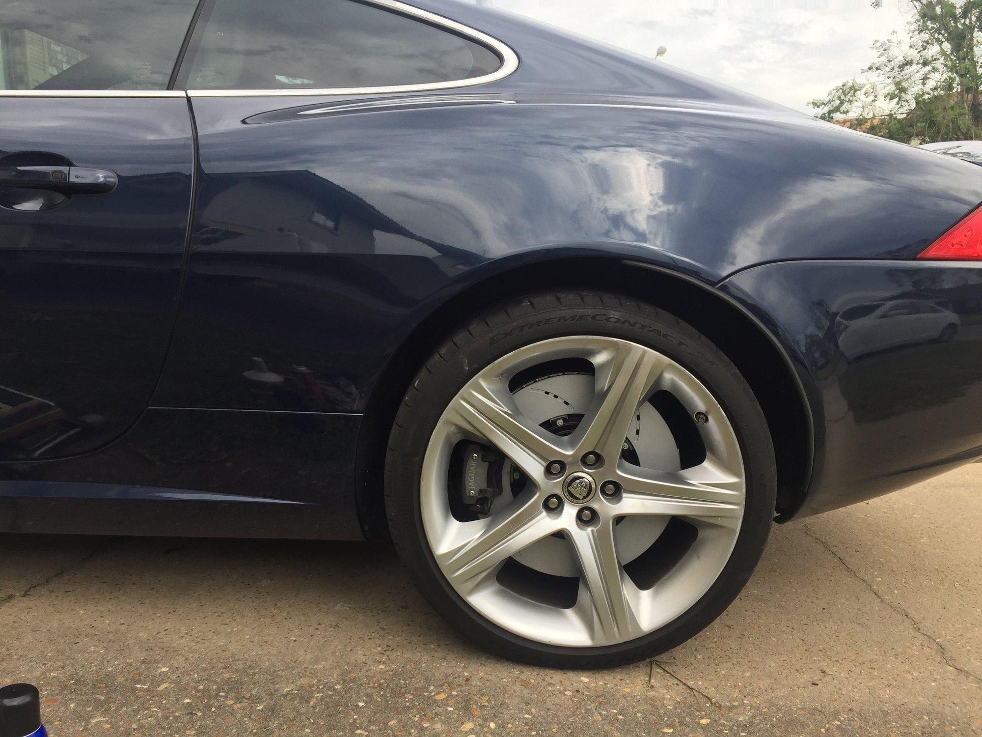

Rear rotor OEM V/S www.racingbrake.com rotor. Yes the rotor is silver painted
Comparison, rear rotors
Slight dia. difference hole to stud. So far no problem during driving. I found spacers/sleeves and will be mounting them in the future.
Rear passenger side.
Looks great. no rust.

in the pictures the new discs look were the pads make contact look thinner if the are thats why there lighter

Yes the rotor is a bit thinner. However! many factors come into play in rotor design. When doing my research ( engineering research ) into such I decided to take the 2 extremes, 1 everyday commuter car type rotors, and 2 all out racing rotors ( Not going into ceramic in this discussion ). These will be general requirements Not specifics.
Everyday rotors need to be thicker mainly due to the nature of the constant wear from the ongoing stop, and go, and stop again driving, and not necessarily because of the amount of power from the engine that the rotors need to convert into heat upon braking .
Conversely a racing rotor needs to be light ( less rotational mass wich is parasitic to the engine Hp.output ) and yet be able to safely convert the power from the engine
( actually vehicles mass and speed ) to heat upon braking . The solution to this is Wind / Airflow, same principle that is used with airflow trough a cars radiator . Hence as one can see from the pictures 10 The cooling vanes are larger. 2) The cooling vanes are circular. 3) The slots go through the rotor , all to increase the heat soaking capacity of the thinner rotor.
Having said that it is important to realize that when a car manufacturer designs a car it is for use in a variety of situations, from stop and go traffic to highway driving
so the design of the rotor in this case call for a jack of all trades, and not any specific. Hence the rotor on our cars.
The way/method used by https://www.racingbrake.com to address the wear caused from stop and go traffic is the use of a higher brinell# steel . Since in stop and go traffic there is less airflow. Hope this sheds some light onto your question . Take care!

Yes they are thinner, and yes the Aluminum hat makes the rotor lighter. Also for a better explanation see my other 2 replies on this date.
