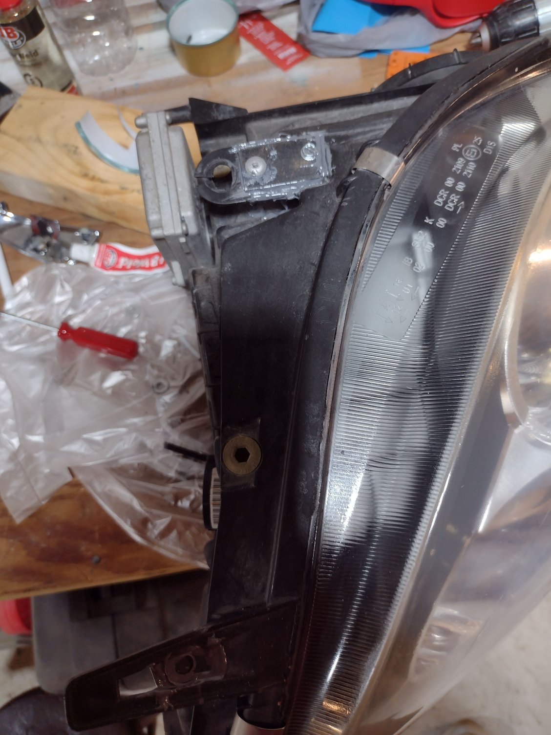

I looked again with a critical eye and saw my right headlight was drooping. Manipulating the assembly found it loose in the frame.
the plan is to adhere some 1/8" aluminum bars to the top surface splicing the breaks and use screws/rivets to reinforce with a layer of JB Weld reinforcing.
in removing the assembly I found that the third bolt which secures the light through the fender is missing which probably contributed to the failure. Does anyone know where to look for the original if it was dropped into the works? Failing that, the size of the replacement fastener needed? Thanks for any input.

The bolt through the fender is the same M6 bolt as the top two. Bought two more at Home Depot under $3.00.
here's the photos of the repaired and reinforced assembly. I have a plastic welding kit on order with Amazon and need to get the mega sized JB Weld to replace my dwindling supply.
