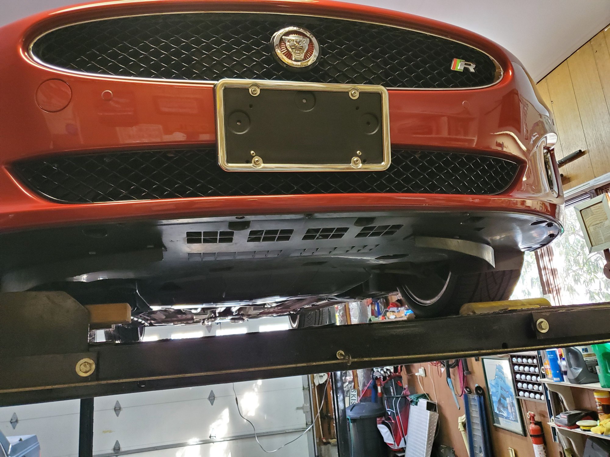

Did they remove the plastic belly pan covering the underside of the engine. Here is my 2012 which I sold last December for $30K , XKR convertible.
I believe they have a photo with it: https://www.elead.us/images/C_8777/aai/110308118.jpg
