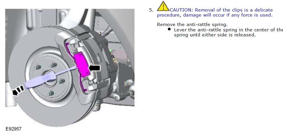

If I am not mistaken, anti-rattle springs are part of the pads (i.e., if I ordered OEM pads, it would come with the springs)? I don't see a separate part number for anti-rattle springs.

I haven't taken my brakes apart but judging by the workshop manual, the anti rattle spring is part of the logo plate and is listed as C2P12427 in the parts manual for the XKR.
