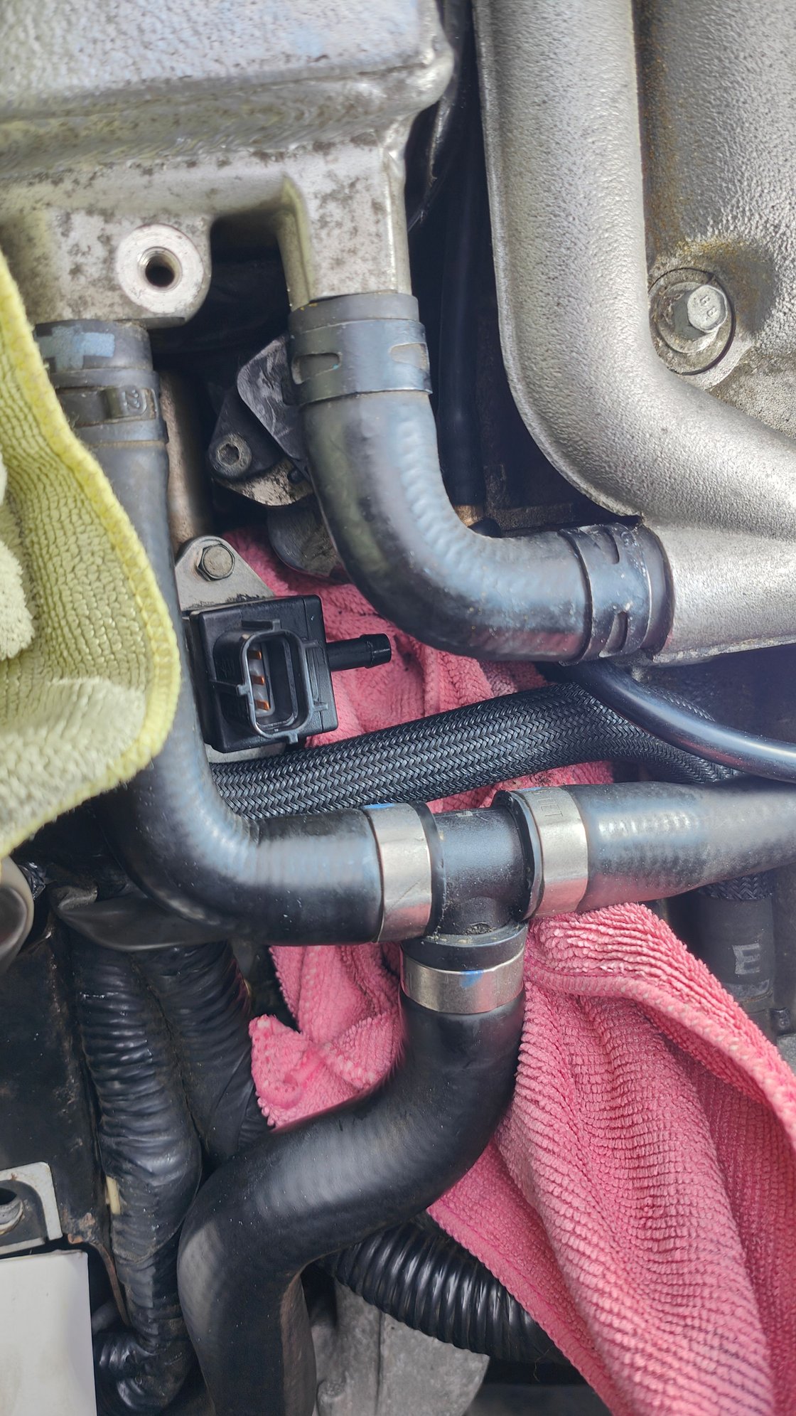

That is why I was suspect of the 5/6 percent lean trims at idle which was due to the vacuum leak, surprisingly it passed MOT tests in England all along with I assume broken vac lines which goes to show the impact was minimal, if I was not shoving my nose into it you would not even know - I broke the nipple of the fuel pressure sensor during my bodge and replaced AJ87977 with a used part, I was not too keen on spending over £100 on a new part but now my trims are around zero at idle which I was not expecting from a 16 year old V8 but its what drew me to this car in the first place, the engine is a masterpiece - you need to keep an eye on it
Changing that fuel pressure sensor was tricky, fortunately I have skinny hands

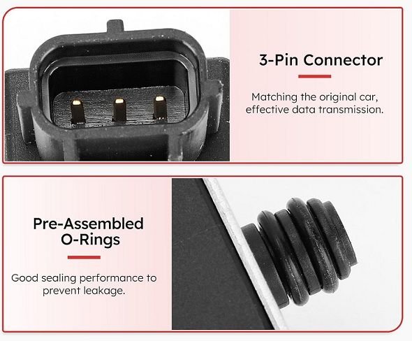

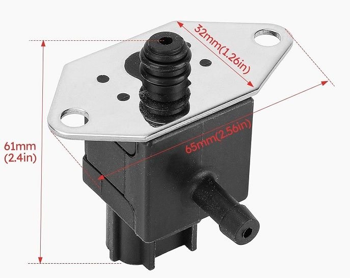

If anyone is interested this FPR is another Ford part that is not documented anywhere and the Ford part as always is much cheaper!
Here is my old thread on replacing the FPR on my 2005 S-Type R.
Jaguar Code P0191 - FPR Failure
The above is a long thread and here is a short version.
Jaguar #AJ87977 List Price about $190
Ford #3R3E-9F972-AA which is printed on the part. List is about $45.
Here is the bottom of the FPR.
And the top showing the electrical connection.
Now I do find it for only $18 and it does show both the Ford and Jaguar applications
FPR FPR
Note the fitment guide only shows a portion of the Jaguar models this fits. So compare yours to the picture and I bet it's the right one!

I spent a while researching the Fuel Sensor, its a significant part in terms of what it does and I was reluctant to get a new sensor from an unknown brand for £30 or whatever, The OE Jag part is from Ford - I was struggling to see these for sale or anything like £30, my used part is a Ford part which I required it to be, so far so good - if it plays up I would just get the OE part new - I cant quite trust these other brands, I have heard stories before on other threads, leaking fuel and erratic performance etc.
I oould be wrong but it looks like Ford no longer make this part.

Here is the FPR from Ford. Again less than $25. You just have to look around to see who has what.
Ford Branded FPR
