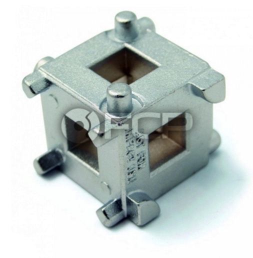

Thanks for the info. Knowing it was going to be pretty straight forward going into it helped. Whole job was done - all 4 with pads and rotors in a little over 3 hours. Lost about an hour b/c somebody already rented the tools for the rear. I was able to do it with a little square tool they sell, but not without a lot of wasted time. You have to really push in (a lot) while turning the piston. After I figured out to push harder, we got it done.

OK, so the trick to resetting the caliper piston, is to insert a tool with a "square" that allows one to "turn" CW while pushing to recess the piston?

Exactly, and push in hard. I was turning while pushing and nothing was happening. You have to really push down hard while turning.
This sounds like the old FORD process from years ago.
Thanks for sharing your experience.
The cube "square" one is a pain to use so if you can borrow or buy one of the better tools do that.

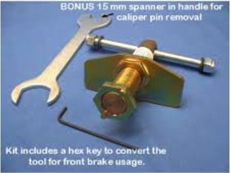

Thanks , I have one like this cube. But the other style shown would be much easier. Anyone know the measurement between the pins?
Attached Thumbnails Changing Pads and Rotors-my-pad-retraction-tool.jpg   Changing Pads and Rotors-rear-pad-retraction-tool.jpg

Get a universal brake caliper tool kit from Harbor Freight ................it will push and rotate rear caliper................

Should you not, determine if the HF tool's pin distance is correct for our Jag caliper pistons? I'm just trying save someone the aggravation of buying a tool getting home and finding it not be correct.

A friend of mine has a kit from Snap on which has an assortment of ends that fit most cars. There was one that work in my 77 Ferrari so there were others that would fit Jags. I know there are other cheaper kits but you would need to look for them.

I bought the Harbor Freight tool some years back and it works fine, multiple adapters. 04 XJR and 07 XKR.
