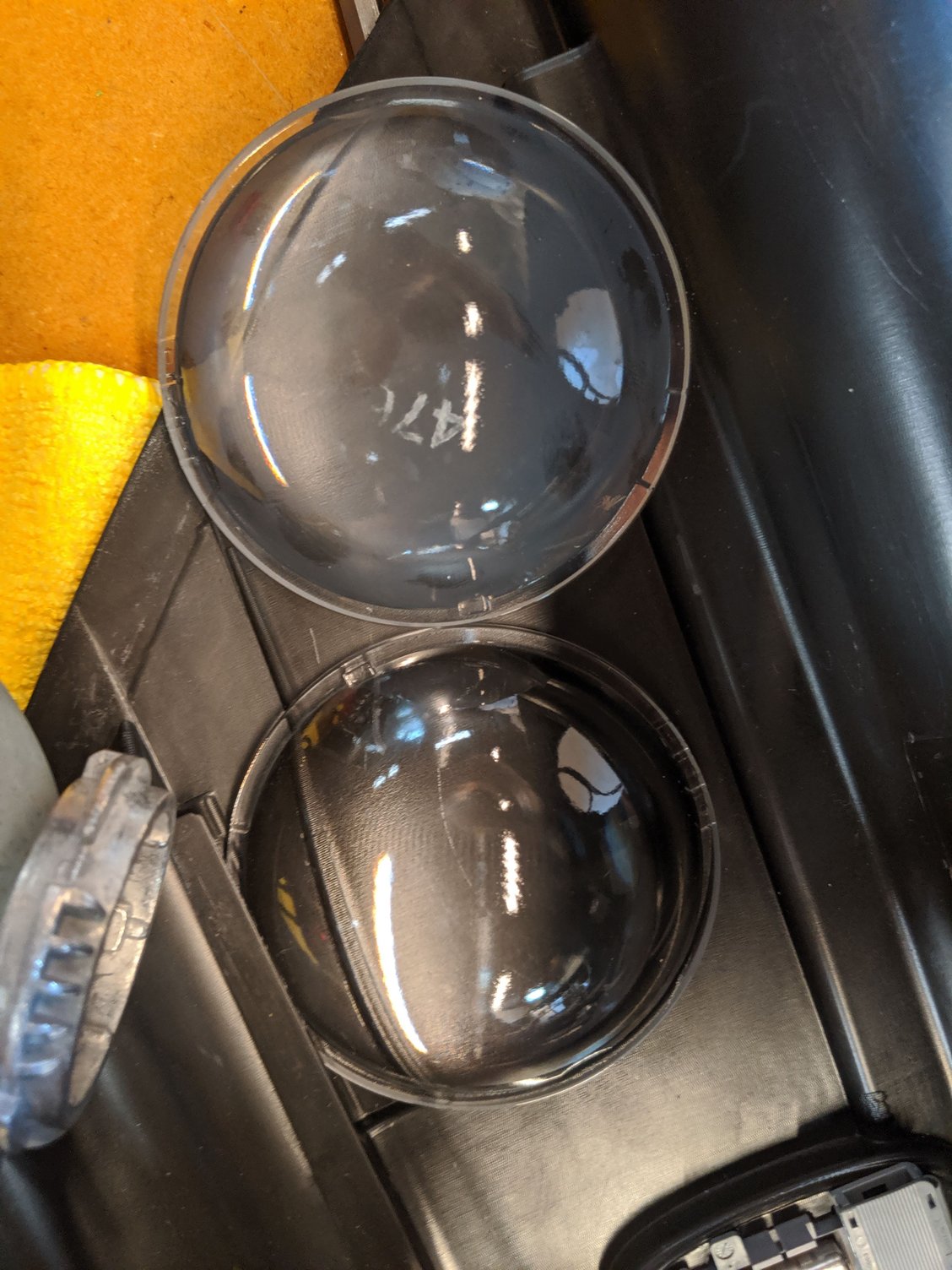

Default Milky projector lenses solved
OK - so I took the headlamp units apart today. The projector lenses had a coating on them - both sides. It was a white, milky coating that came off easily with the wipe of a soft cloth. To get at the lenses, the internal housing for the lenses had to come apart and be removed. It was easy - four additional torx screws and some careful prying of tabs that held the lenses in. I have a feeling clean lenses is going to make a big difference to the headlight beams. They were somewhat weak and diffuse before. Once I get them back together I'll see how big the difference is.
I used the oven technique and it worked like a charm. In addition to the excellent guide on this forum, I checked other resources because I was worried about the heat. Interestingly, those other resources suggested temperatures from 200 - 220 - so the 160 in our forum's guide is conservative. But it was enough to do the trick - plus less risk, of course. Additionally, what I did is I heated up the over then turned off the oven before putting in the headlamps. I did not want to risk a hot element creating too much heat near it. Our oven holds heat for a long time, so this worked perfectly. I was also easily able to handle the headlamps without gloves - which is a bonus.
I can't put them back together just yet because I discovered that the wire insulation in one of the lights had become brittle and failed in many places (no - not as a result of the oven - I saw it before taking them apart). So tomorrow's task is cleaning all that up. I'll post that update in another thread.
In the meantime, see below for a before and after of the lenses. The difference in person was more striking than it appears in the photos.
