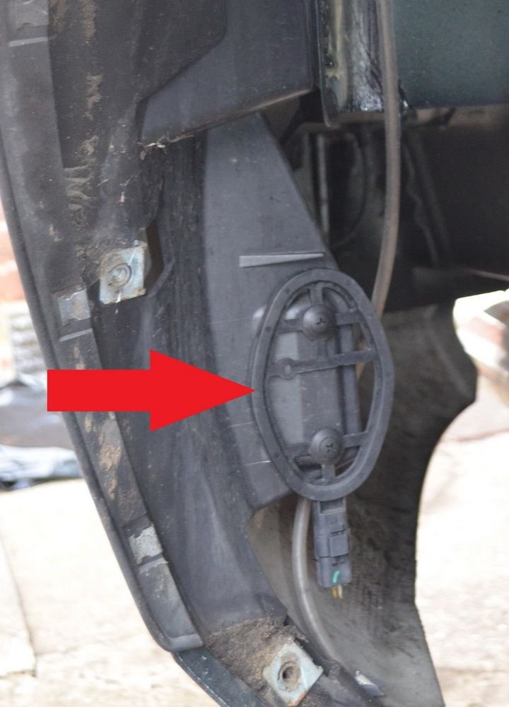

I agree Sensor is most likely but the intermittent nature of the fault means it could be the front right TPI (Tyre Pressure Initiator) or its harness connector.
The four TPI's on the vehicle are identical and can be swapped between locations to see if the fault also moves.
