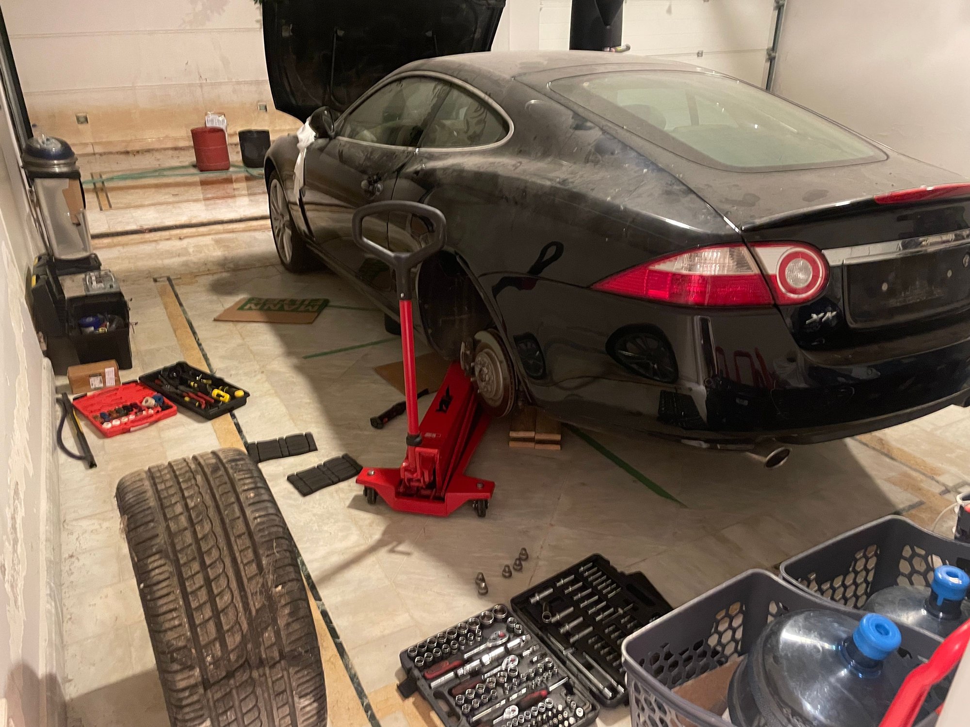

This xk was idle for 4 years
Have released the fuel line to the rail and will now remove the fuel filter and with pressured air will blow the lines clean them and change the filter
Have added already20 litrews of fresh gas with Wurth cleaner
What do you think any suggestions

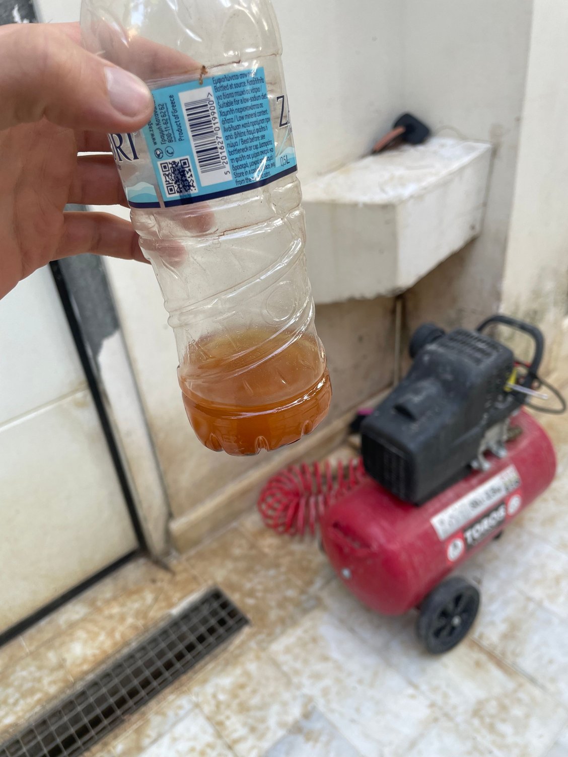

this is the fuel blown from the fuel line from fuel filter to rail .. it barely smells fuel

That's the color of the fuel!? Yeesh!
