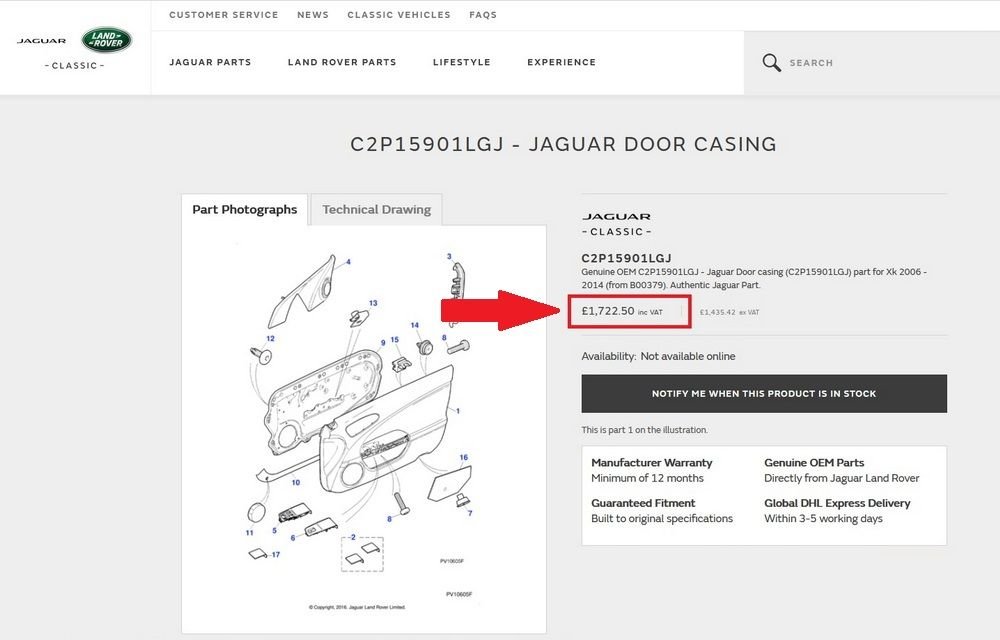

Originally Posted by McJag222
Looks like they are the same according to "what's this fit" here for the left side door
This product fits 52 vehicle variants.
Jaguar: 3 models, 52 variants between 2007 and 2015.
https://parts.jaguarpalmbeach.com/p/...P15901LGJ.html
That looked a frightening price.
I knew parts were loaded in USA and Canada against the equivalent in the UK but this makes a interesting comparison.
The 1722 UKP cost (which includes taxes) converts to 2117 USD or 379 USD less.
Then there's the NOT AVAILABLE ONLINE caveat.
Old Nov 9, 2023 | 10:21 AM
Likes: 17,003
The increasing problem with Jaguar parts is NOT AVAILABLE, online or otherwise. I'm still waiting for an F-Pace RH front door after five weeks and that's for a current model.
