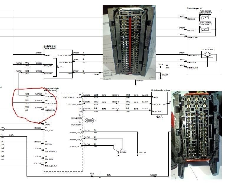

Hello,
I have the OBD code P0232-24 on my 2011 X150. The fuel pump module is new. I am now looking for a fault on the wiring between the ECM and the fuel pump module. I've disconnected the two connectors on the ECM but I can't find the two wires I'm interested in, FL072/28 and FL072/24. How can I find them on the connectors?

Hi,
I registered for an hour on the Topix site. I found all the connectors, their locations and pin descriptions. I checked the wires between the ECU and the pump connector. The blue/red wire was cut. It took me 4 hours to find where the wire was cut. Right where the shield ends near the pump connector.
I soldered a new wire and the car works perfectly.
