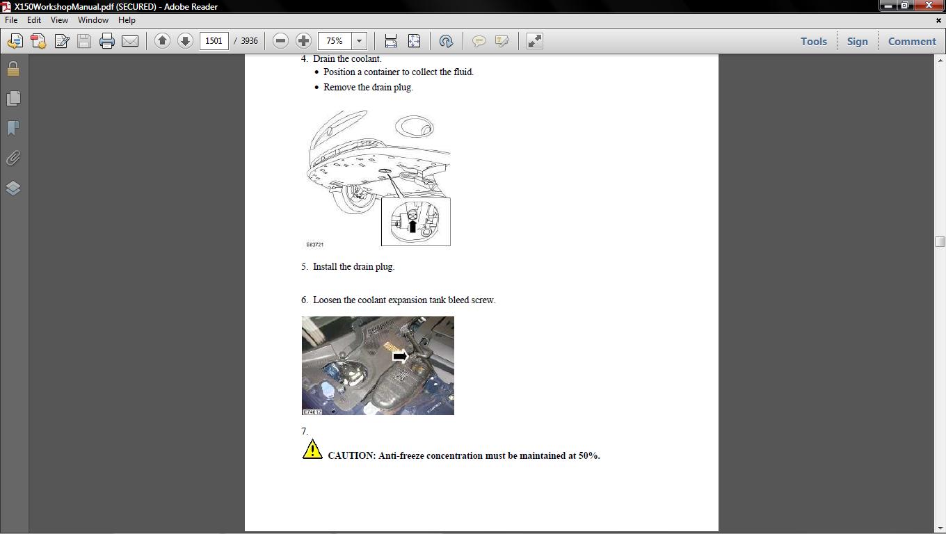

How would I bleed the cooling system if I have air in it. Also how could I change the thermostat are there any guides?

OK, how does air get into the system. Almost anytime the cooling system is opened, for whatever reason, air can enter the system. To what degree, depends on what service work is being performed. Changing a radiator is major, as the system has to be drained.
I'm of the opinion the cooling system will self-bleed, if the previous mechanical work was completed in a professional manner.
These days, most all of our motor vehicles run closed cooling systems. They have either an expansion tank or overflow coolant recovery system. These tanks are located near the radiator and is the place we "top-off" our cooling systems. As owners, need to insure these tanks are filled to a recommended fill line on them. This being the case, as the engine cycles through heat and cooling cycles, the pressure cap allows for radiator coolant to flow either into these tanks (heated) or from the tank back into the radiator during the cooling cycle. This movement of coolant, will expunge any air trapped in the cooling system. So, if you check your tank and it is full and you have driven often enough to have several of these "cycles", most likely, bleeding is not your problem. As was mentioned, I would check the temperature switch.This switch tells the fans when to turn on and when to turn off. Us old "E-Type" guys call these switches an "Otter" switch.

Ken during the drain and refill of a cooling system there may be some areas where a air pocket forms. These become hot spots and at times take a long time to go away. Coming from the old Ferrari community we would spend hours in bleeding the systems and Ferrari designed in multiple bleed ports specifically designed for this. As to Jag I don't have enough knowledge yet on the engine/cooling system so I only suggested that maybe there was air in the system. Just like a hot water heating system when refilling air gets trapped and causes problems. So if we assume the system is air free then I would go to the old otter switch (66 E-type guy here) and see if that is the problem but if it was bad I would thing it would be either on or off all of the time. Just sayin
Simply stated, removing trapped air in the system is exactly what occurs by circulating coolant, letting the engine cool, re-firing and running again. As I mentioned, with the engine running, both, air and coolant are circulated to the radiator and to some extent, on into the expansion tank where any air is trapped. As the engine cools, only coolant returns to the engine, therefore, replacing any air, previously expelled. While this may take a bit longer, it is affective for the novice DIY'er. Explaining this is not so much for your benefit, as it is for the gentleman seeming challenged as to how this process works.
Another method (requires more skills), I've used to speed up the "burping", is remove any water ported plugs in the highest most section of the engine. Idle the engine and begin filling the system through the radiator until coolant is seen at these ports (this assumes the T/S is open). Shut the engine down and replace the plugs. Wish we had those "bleed" ports, btw.....
