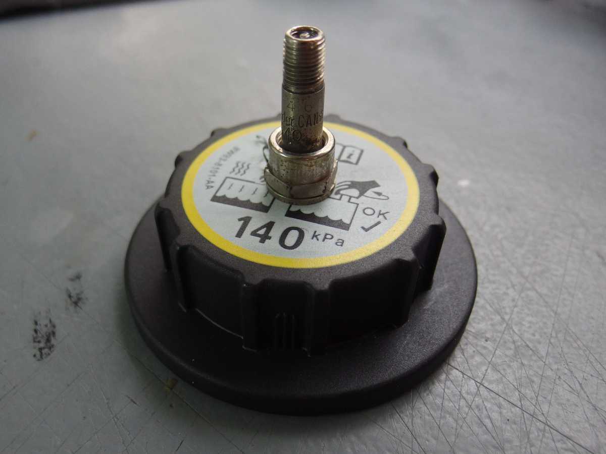

I have crawled around the underside after holding my handheld tested on the tank for 4 minutes (constant pressure from compressor) earlier today, there were no changes, no leaking fluid. Using another approach I added a schrader valve to an old reservoir cap and tried to pump it up, I couldn't build any pressure!

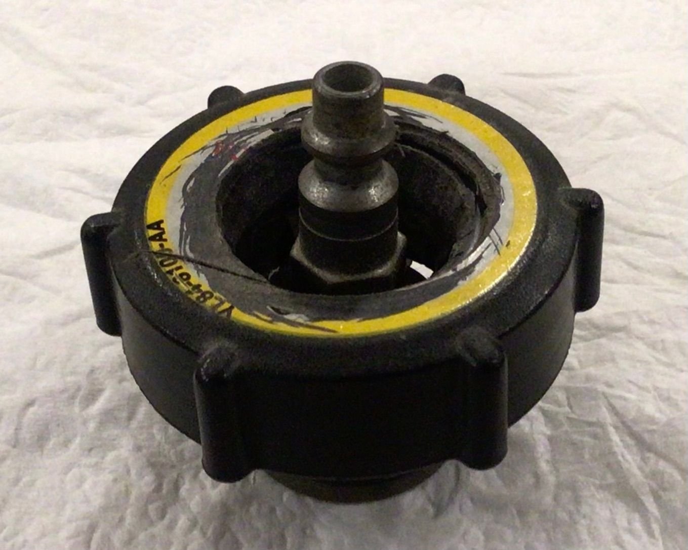

A few years back I did this with an old reservoir cap to find a leak in a Ford Escape:
Turn the regulator on the air compressor down to zero, plug the air hose on the cap, and then sloooooowly turn up the regulator until you have 5 or 10 PSI. Hard for a leak to hide under those conditions. Most coolant pressure caps blow at about 16 PSI, so I wouldn’t go any higher than that with the air.

currently removing hoses, saw a slight damp spot behind crank pulley...
my previous testing included:
