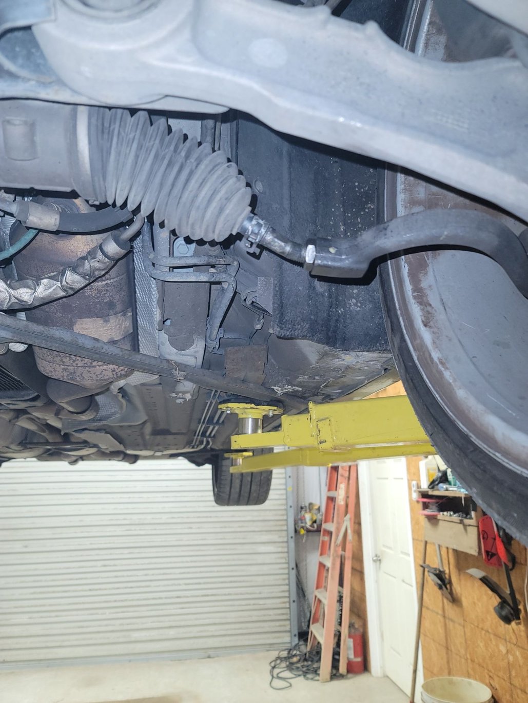

Found out why steering wheel off center
Old Sep 23, 2022 | 09:04 AM
MudDog's Avatar
Joined: Jul 2022
Posts: 186
Likes: 111
From: Mobile
Default Found out why steering wheel off center
Pic worth a 1000 words

Dang. After my car sideswiped a curb, the alignment rack showed the toe 1.5 degrees out of whack. This looks like it might be worse.

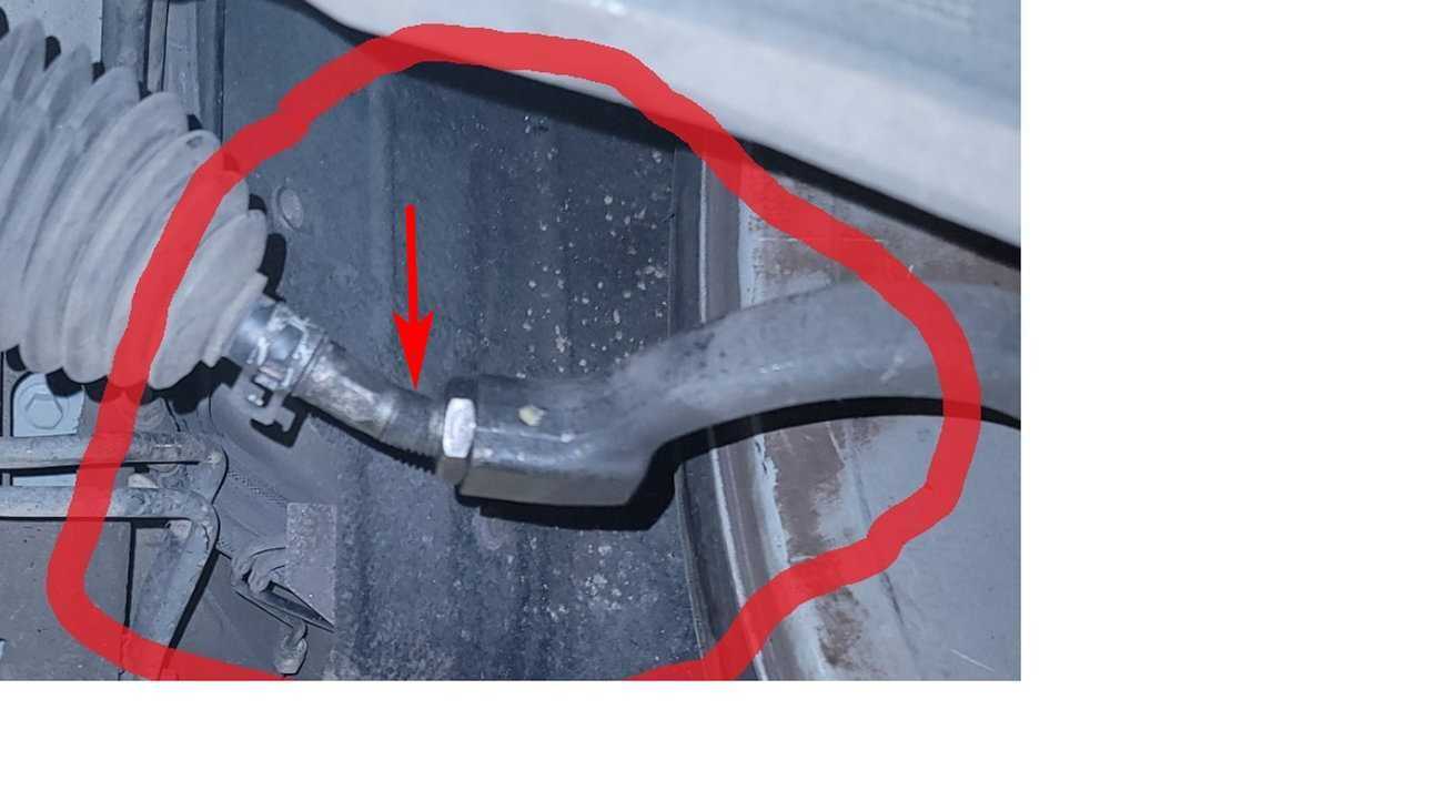

For those of us who don't know what we're looking at, please circle or arrow the part in question.
Here ya go

for those that have never seen the steering rack...more clarity...it is bent at the threads...it should be straight!

Looks like an easy fix with my sledgehammer! .
Seriously, you must have hit a deep pothole or whacked a curb pretty hard to bend that link. I hope the wheel isn't bent. If it's slowly losing air, it may be cracked.
ha, bought it that way. keeping an eye on tire pressure.
