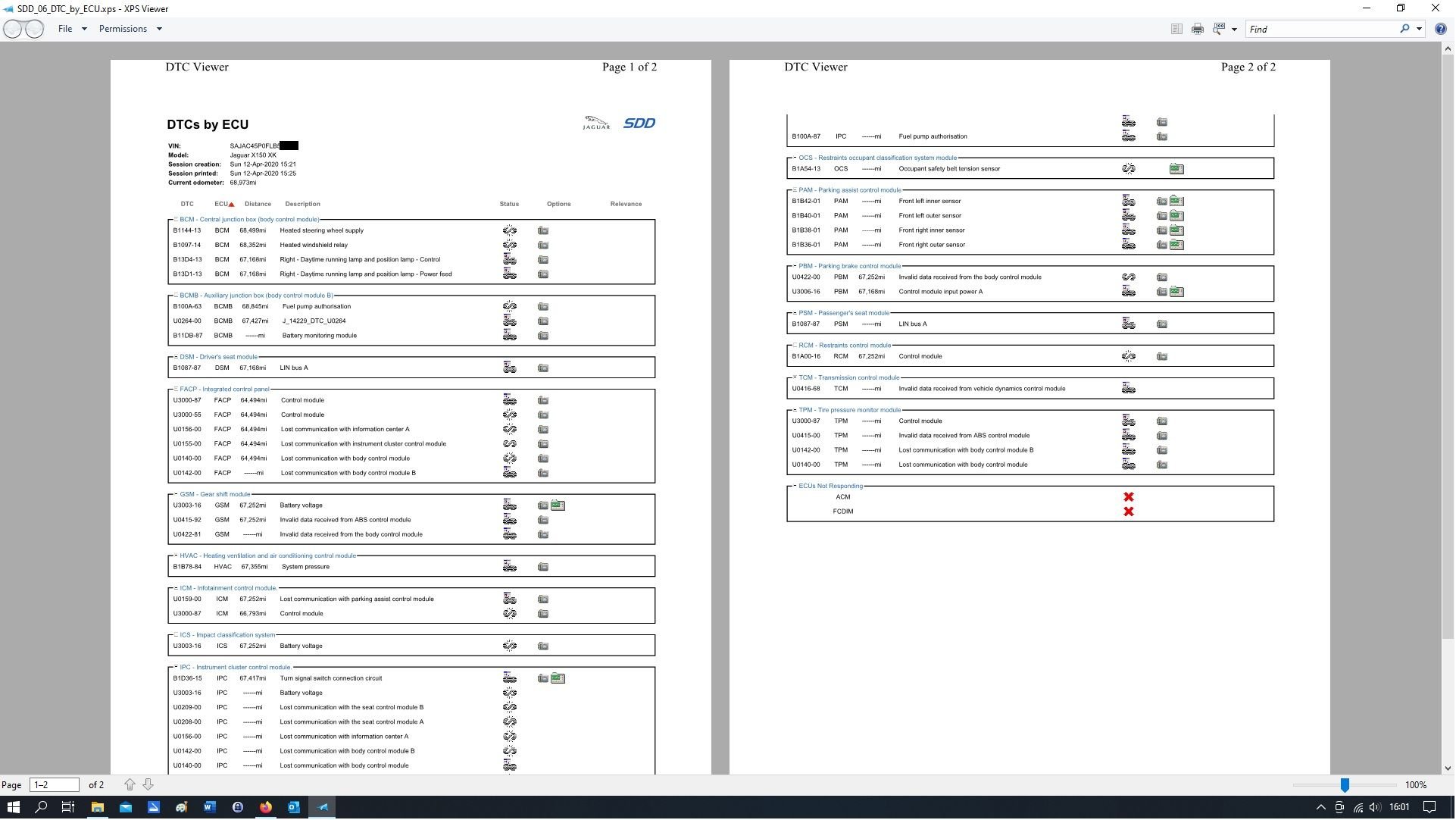

I often find lots of codes have been recorded when I run an SDD session. Many are not errors but simply "out-of-range" readings which record a diagnostic code. If the vehicle is running well, you could be looking for trouble that is not really there.
Here's an example of a check session on my XK:
Lots of codes listed but nothing there to worry about.

some of your codes are also present in my car. I am calmed down.
