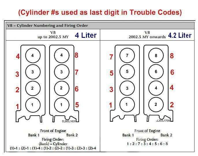

Unless it’s at the front of the engine basically cylinders 1 and 2, you can’t really get to a lot with the intercoolers on. You need to pull the supercharger to pull the intercoolers. At least from my X100 and X308 experiences. Maybe others can chime in and hopefully prove me wrong since it’s better if I am wrong. I’m betting SC r&r is a grand or more if you pay a shop.
I was lucky on my 2000 X100 when this happened it was the front most injector on the LH side aka Bank 2 Cylinder 1 aka Code Cylinder Number 5. After testing the wiring, it was good, and the injector itself was bad per resistance, $40 and I was back trucking.
