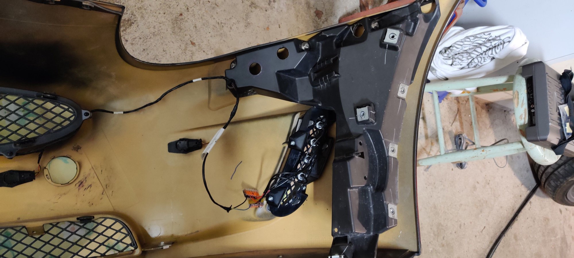

Long story short, changing the old style cover with fog lights to the new style. The guy I purchased it from called and asked for a bracket and he swore the brackets are the same old to new style, it appears they are close but different and things are not lining up just right. Anyone here have and extra bracket to sale.

I used the old bumper brackets, there was only a bottom bolt I couldn't use.
I drilled the pop rivits and mounted it to the new bumper with bolts. When drilling out the rivit's I made the hole bigger on the bracket as I slipped so I bolted them to the bumper instead. To be able to use bolts I drilled a large hole on the side to get the nut and washer on.

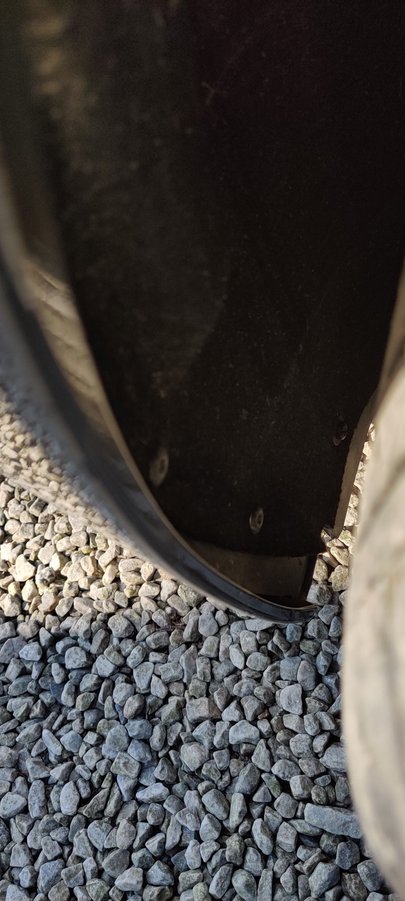

I couldn't find new inner liners for a reasonable price but with the old brackets the inner liner lines up perfect to the old on the car. As the new bumper is wider I bought a second hand inner liner from a scrapyard to extend the smal gap to the fender. With wheels on you can't see it.:-)

Originally Posted by peterv8
... As the new bumper is wider I bought a second hand inner liner from a scrapyard to extend the smal gap to the fender. With wheels on you can't see it.:-)
not sure I understand
do you have a picture please ?

Here's the pic! :-)

From: Israel
Thumbs up
Got it know
Thanks
