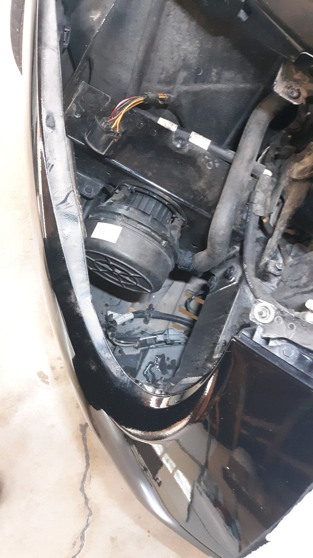

remove right side front wheel well liner and you'll have acess or remove r headlight, same scenario.
wj

I'm assuming the squeal is actually the blower motor within the airpump. It is a squirrel cage type. I replaced mine, don't quite remember the exact procedure but it was straight forward. Unbolt several rubber feet mounts, unplug electrical, remove the pump's exhaust tube...reverse procedure.
wj

Why not spend a little time, remove headlight 15min, remove front shroud on air pump, 30 seconds. spray a bit of wd40 onto the motor shaft. Reverse steps and see if that helped? Less than an hour's time. Might save you for a few years.
To answer the question, not a problem as long as it continues to spin, noisy or quiet.
WJ

That I will do. I might be able to get to the back of motor from engine bay, or do I need to spray from the other end?
