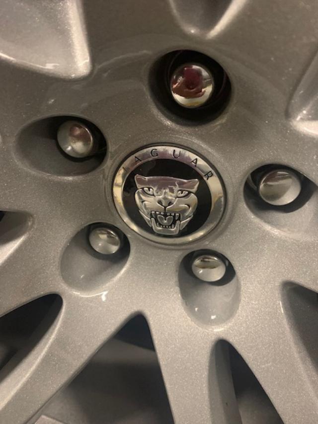

I went to a tire shop to balance some wheels. A few days later I had to take off my front wheels to change brake pads. These clowns from the tire shop torqued my wheels down so tight; I couldn't get the lugs off. The cover on the bolts caused the lugs to be stripped. has anyone had that experience?

to get them off you have to remove the outer casing punch a hole dead center trough the casing and use a pair of needle nose pliers to remove the casing be care full not to scratch your wheels !!!! use the next size smaller socket and take them off you might have to force the smaller socket on then order stainless steel solid lugs and you will never have this problem again there called swollen lugs see it all the time Ran

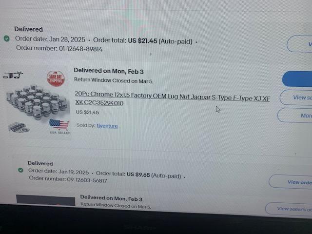

these are the ones
you need

Originally Posted by rancopyman
these are the ones you need
If they are actually OEM, they are the junk two-piece nuts that should never be used, ever.

there on my xkr right now they are solid stainless steel one piece
The seller’s eBay ad says that they are SCM steel. The "SCM" in the designation stands for "steel, chromium, molybdenum."
A Japanese standard, although it doesn’t say what grade it is.

i like them they went on fine look good you have to make your owe decision on what you want
