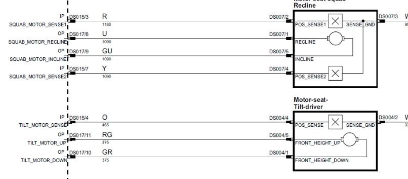

Anyway, I seem to recall you can just add voltage to the seat motors using the connector. I've no idea which pins are necessary though.

Use the wire colors to identify the connector pins as Cee Jay said:

See attached extract from workshop manual, available in the stickies at top of forum. This fly lead allows you to adjust seats fore and aft, assuming motor & seat track are not too badly damaged.
