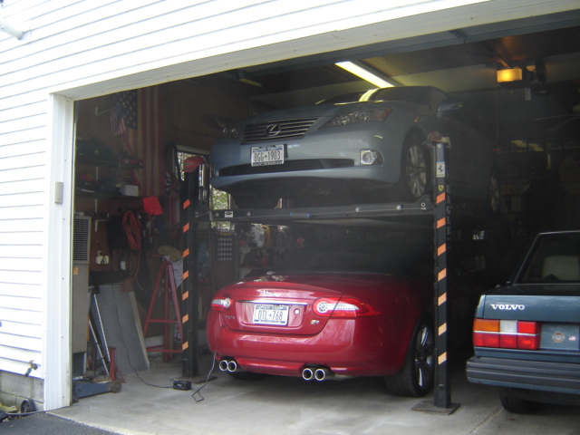

I had to go 4 post so I'd have an extra parking place.
Well jagtoes, that's a nice enviable position to have in your pocket.
I'm struggling with a 95" ceiling height. I have friends with your setup. Nice!
