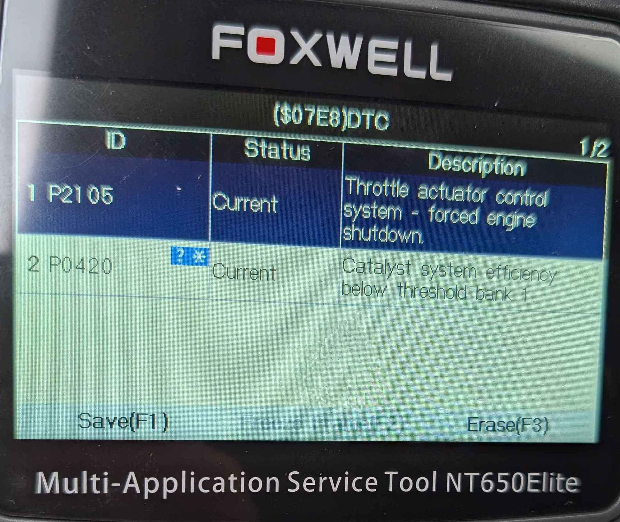

Have the battery hooked up to a charger right now. Gonna let that go for a while. Did not attempt to start car again, but did pull codes before I took the battery out. My device gave me these codes.100k miles - could the cats being clogged/clogged just enough, cause a misfire? Does the first code exist purely because it went into limp mode?

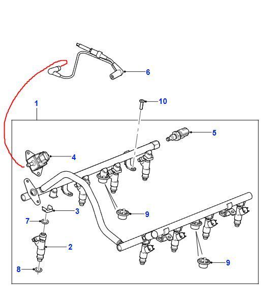

I had a similar issue with the RPMs fluttering at idle, and for me, the problem was a vacuum hose connected to the fuel pressure sensor/regulator. The plastic piece on it was broken, and someone had poorly glued it.
