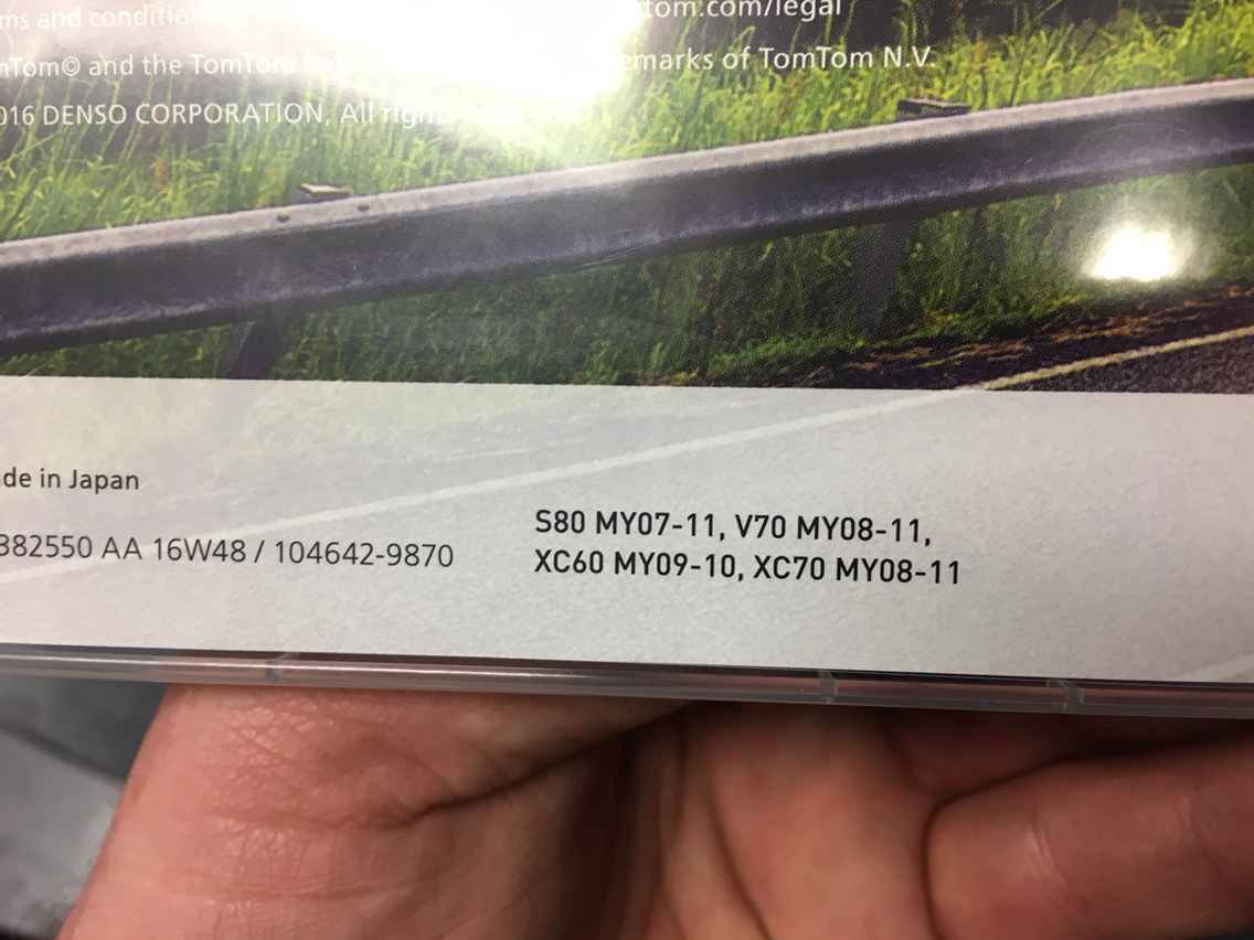

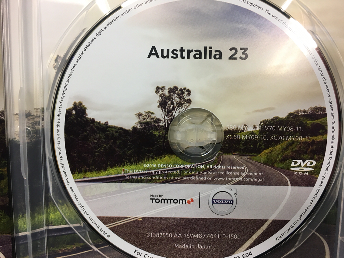

Have a look for a newer Volvo disc, to suit these models:
In Australia the newest disc for the XK (and XF, and the LR2, LR3 and Range Rover Sport up to 2009MY) is from 2013, but those Volvo models use the same system, and the discs are 100% compatible.
I've got a 2017 Volvo version in my XKR, works perfectly.

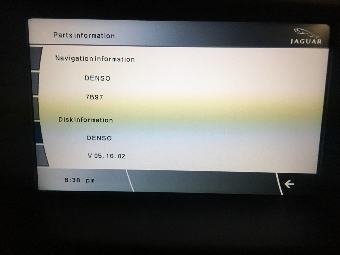

Note that the map version date is one year behind the market release, V 05.16.02 is 2016, but it's sold as a 2017 update.

You need the DVD, not the USB/HDD version.
Those Volvo models listed; S80 from 2007-2011, V70 from 2008-2011, XC60 form 2009-2010 & XC70 from 2008-2011, use DVD's the same as our XK's.
Some Volvo's have an internal HDD which stores the maps, those are a different system, not compatible with the XK.

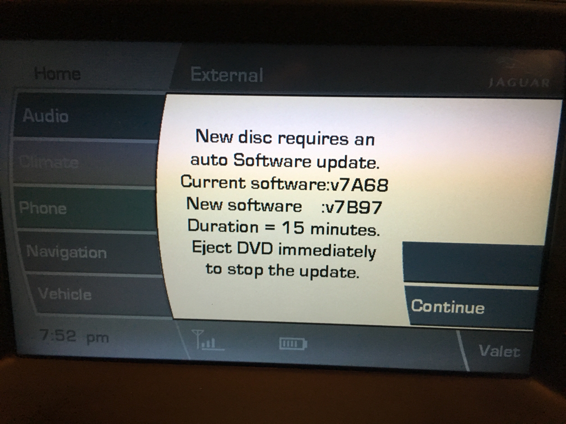

That Volvo deal sounds intriguing, but how would the Software Update included integrate with the Jag stuff?
Old Oct 24, 2017 | 08:39 PM
Cambo's Avatar
Joined: Jan 2011
Posts: 8,637
Likes: 4,526
From: Sydney, Australia
The software update was installed in mine, and there's nothing "Volvo" about it. It just works. Could be a placebo effect but it seems to work a bit faster than before.
The DVD drive is the brains of the Navigation, I guess there were some improvements made by Denso (the maker of the Nav unit) to the software that runs the drive, this is completely separate to the touchscreen with the Jaguar logos, menus, etc.

What is the process for the software upgrade?
Old Oct 25, 2017 | 02:15 PM
Cambo's Avatar
Joined: Jan 2011
Posts: 8,637
Likes: 4,526
Put the DVD in, press continue and wait 15 minutes

One thing of note. I only wanted the "B" disk for the Eastern US, so just jumped right in with that disk. Got "loading map data" for a really long time, so went back and inserted disk A. Got the software message, when that finished I reinserted the B Disk and everything is fine. So apparently Volvo only put the software update on Disk A. Warning to all.
