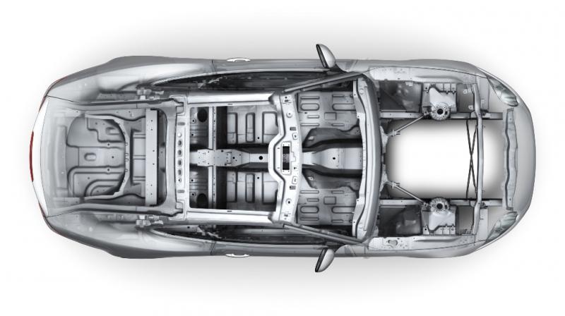

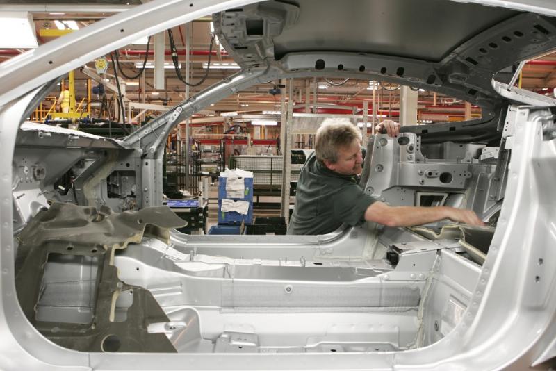

I would actually like a sunroof as well but probably wouldn't get an aftermarket one fitted.
Do the attached pics help you?
Yes that is a big help, thank you very much...
Great examples...
Looking at the window frames in pic 2 makes me wish they had installed operable back windows on the coupes too.
As far as the sunroof goes another cool option since there is no slide into space would be a targa type top but maintain the over the window side beams.

Originally Posted by Mike V
Great examples...
Yes. long ago I owned a 1974 corvette coupe with a factory T-top, I liked that a lot, but you did have to stop and take the panels out and put them in the back... not so bad when I was in my flexible 20s... not workable here because of the supports running over each side window...I might not mind a removable tinted glass pannel that took up most of the roof, leaving the supports in tact....so even when it was in.. you would have plenty of light.... have to think about that...
