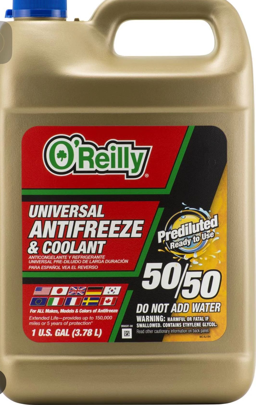

Does anyone know if this coolant is ok for my 2011 Jaguar XK... The site says yes, my refractometer says it's good.. Just want that extra reassurance. It's a yellow...

Does it say OAT on the reverse?

yes sir Richard.. it says that it's compatible in the list of vehicles.. I'm just weary of universal anything... It was tested alongside AMSOIL which is excellent coolant, it's a little cloudy but it's as close as they can get to AMISOL..

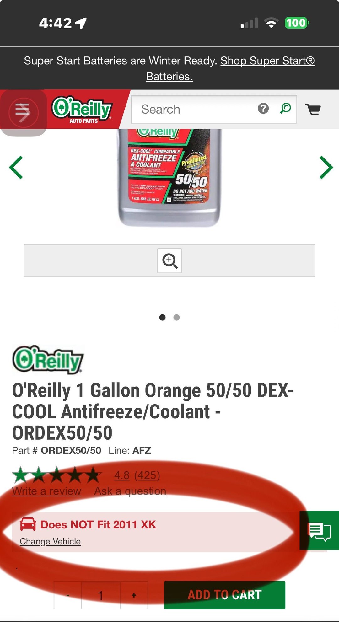

Hey Sean!!!.. It says it doesn't fit my car type?.. I know that chemistry looks similar to the Motorcraft Ford DEX coolant and it's orange... There is no Jaguar vehicle type in the compatibility list?... But as far as Universal it is OAT based, no silicates, and contains ethylene glycol...

I wonder about why use the "PREDILUTED", which means you're paying nearly double. A half gallon of coolant and a half gallon of water.

Yes I never buy the 50/50 in case I want better freeze protection so the ratio would change to 60/40-70/30... plus you get more for the same price 2 4 1

Hey @Matusco , the first one you posted isn't dex-cool (OAT), but the one I posted and you have in post #5 is. Yes OAT contains ethylene glycol. You're good to go with it.

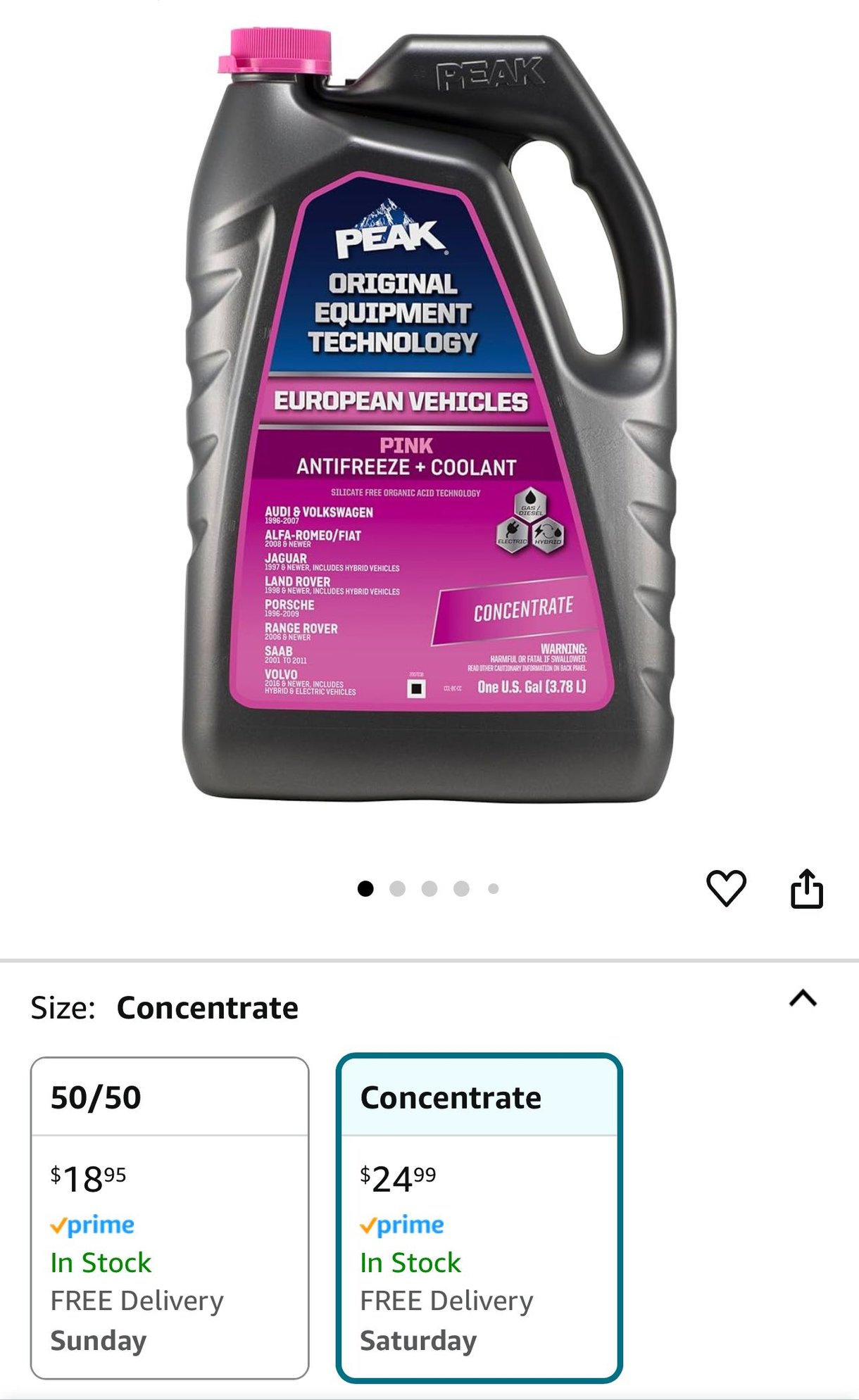

what about if I just say F- - k all the coolant companies and buy this ?

Don't get too fixated on colour or the glycol base. OAT (aka Longlife) antifreeze is the one you need and is usually ethylene glycol based but it could be propylene glycol based, just as IAT antifreeze (the older formulation which needs to be changed every 3 years or so) can be ethylene glycol based.
Both OAT and IAT come in all colours. The original supplied in the x150 is a pink version of OAT which seems to the most common in the UK, but I also have green, blue, yellow and colourless OAT on my shelves as my various cars and bikes use all variations.
If you currently have pink in your car (it sometimes looks red or orange in the bottle), then I would stick with pink as mixing colours always ends up a muddy brown, although it works perfectly well. As long as you use an OAT antifreeze, which could be ethylene glycol or propylene glycol based, ethylene glycol being better for heat transfer but a lot more toxic, you'll be fine. The two glycol types are mixable but most people would not want to mix OAT and IAT although this is usually only an issue with cars from the previous millennium.
