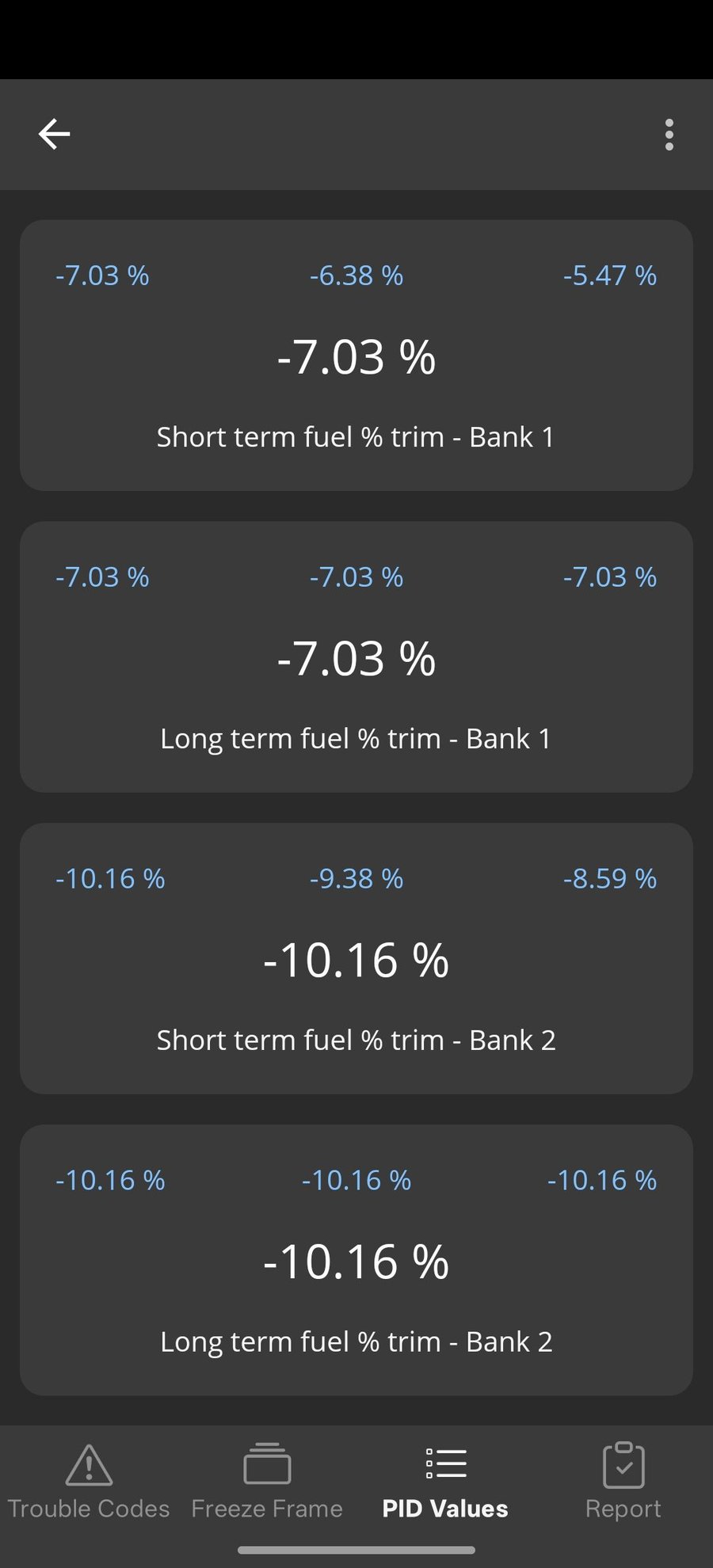

Hi all,
Having a bit of a headache with this not sure why only one bank would be running rich but please see the attached data from fusion. Any ideas ? For reference 2012 xkr 5.0 sc 88k miles

what are trims bank to bank.
Old Aug 31, 2025 | 03:59 AM
Jayden l33's Avatar
Joined: Jul 2025
Posts: 14
These are 2 just taken at idle
garbage trims on both banks.
does your oil smell like gas

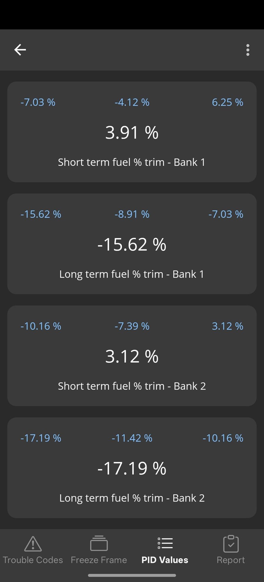

Not that I've noticed I fixed a small all leak I found today behind the maf sensor on one side I'll see what the trims are like tomorrow

I fixed an vacuum leak I found just after the maf on one side and now these are the trims but still seems to struggle starting
Idle
3k revs

Leaks cause +ve trims but you have -ve so it's one of the causes for running rich (such as dirty MAF).
(It's still good to find any leaks as they're another source of pain.)

I cleaned the maf sensors replaced the alternator because apparently it was giving inconsistent voltage and have had the O2 sensors cleaned just as a precaution to no avail. I now have no codes for running rich however the long term fuel trims are both still below -11%. I'm inclined now to believe something in the fuel system is wrong but surely I would get a code for it
