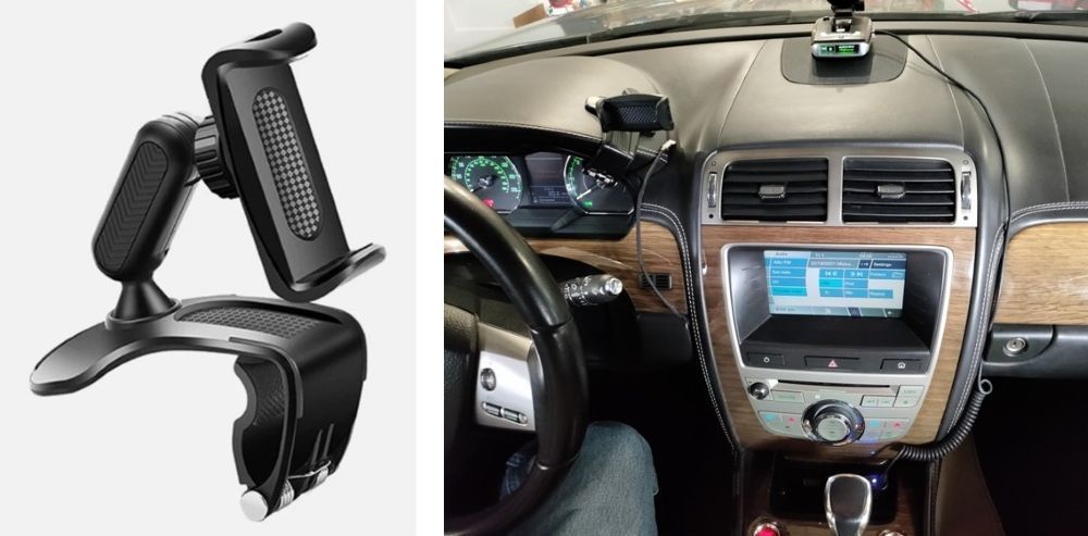

@bocatrip , when I purchased my XKR last November, I also had to figure out how to upgrade it for Bluetooth streaming. Although my car has the USB/iPod input, I have an Android phone so cannot speak to the iPod adapter methods others have mentioned. My research into Bluetooth upgrades ultimately led me to enable AUX input and install a Bluetooth adapter; however, because that path took a few months to come together, I temporarily used one of the easiest ways to stream - a Bluetooth FM transmitter. The sound quality does suffer as it is no better than FM radio, but it is very simple and inexpensive. I selected the Nulaxy FM transmitter pictured below because it can be plugged into the glove box’s 12v socket, it has a fast-charging USB port, and its cord allows adjustments from the driver’s seat - then the unit could be hidden in the glove box. It simply automatically connects to your phone when the ignition is turned on.
I have now upgraded to a Bluetooth adapter and enjoy the superior sound quality. The adapter I chose allows use of steering-wheel buttons for pause/track-forward/track-backward and provides very high-quality sound from its aptX LL codecs. To go this path, you will need to enable AUX input using SDD software. Installing the adapter is a fairly easy DIY project.
Originally Posted by bocatrip
...Can anyone recommend an IPhone car holder for the XK? I prefer nothing that attaches to the vents...
Regarding a phone holder, I use one from eBay that attaches with a spring clip to the dash surrounding the speedometer. I chose this holder because it gets the phone’s navigation up near my line-of-sight so I don’t have to look down at the infotainment screen. For keeping the phone charged, I ran a cord from the glove box’s power socket, down between the infotainment unit and ashtray, and out the trim piece below the aspirator as seen in the picture below (not the visible, coiled cord as that's for the radar detector).
