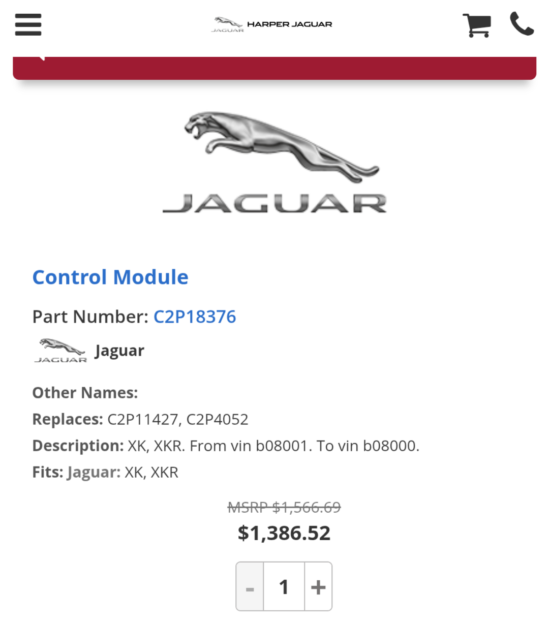

I had to have the vehicle towed to the dealer. The parking brake control module needs replaced the part number is C2P18376, does anybody have a source that offers less expensive pricing for new parts or a good source period.

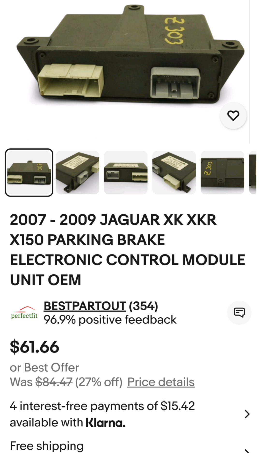

Here's a used module for only $61.66 on eBay, a small fraction of the cost of a new one. I'd give it a try. What do you have to lose? eBay guarantees it'll work or your money back.
https://ebay.us/m/w7HYuP

The dealer probably won't accept that used part. If so, I would have the car towed to a local independent ASE Certified mechanic. You'll save thousands of $$$$.

The dealer was going to charge $1500 for the part. I did find new ones on different Jaguar sites for $1386. I have chosen to purchase a used part from Noma Auto Parts on Ebay, they are located in Texas. They check the VIN and verify it is the correct part before shipping it. I also paid extra and they are sending the part overnight so I should have it this morning. The dealer has agreed to install the used part, so I will take it to them on Monday. Noma warranties the part for 90 days, for the savings I am willing to take the chance. The air conditioner isn't cooling fully and they say it has a small leak, they haven't been able to locate the leak yet. I may just have them charge it and see how long that will last. They told me the valve cover gaskets are leaking, i inquired as to how much that would be and it is $1400, they said the labor is four hours. I may look at doing that myself, I will check it when I get it back, I don't believe they are leaking much. The car has been very dependable, it only has about 45,000 miles on it. Other than regular maintenance this is the only major repairs, not bad for an eighteen year old car. As always thanks for the input.
