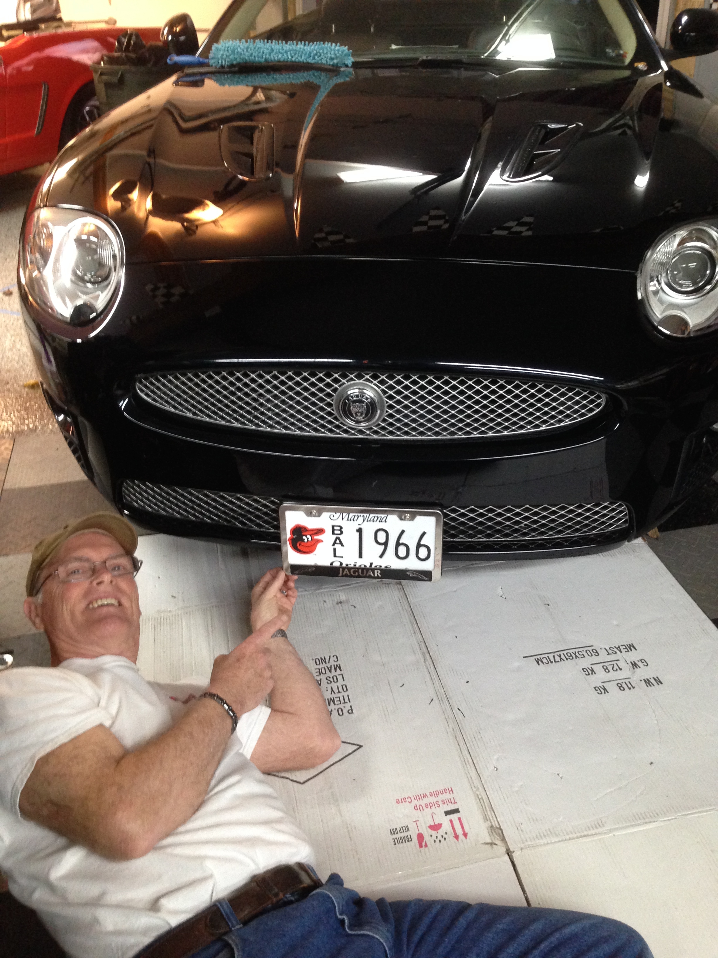

Not sure what you mean by "James Bond" type, but, I installed a non- electric version on mine. The electric version would have needed wiring and a switch, that I didn't want nor feel was worth the effort. Sure, it would have been a "gee whizz" kool install, but that's all.
It's called a "Show N Go" and sold by a company called Altec. It was a breeze to install on my '08 XK-R. Only had to add two additional 5/16" holes in the center, near the front of the belly pan. I chose the center, as there are oil coolers on either side behind the lower grill. I posted pics of my experience here, last fall, after receiving a $70 ticket.

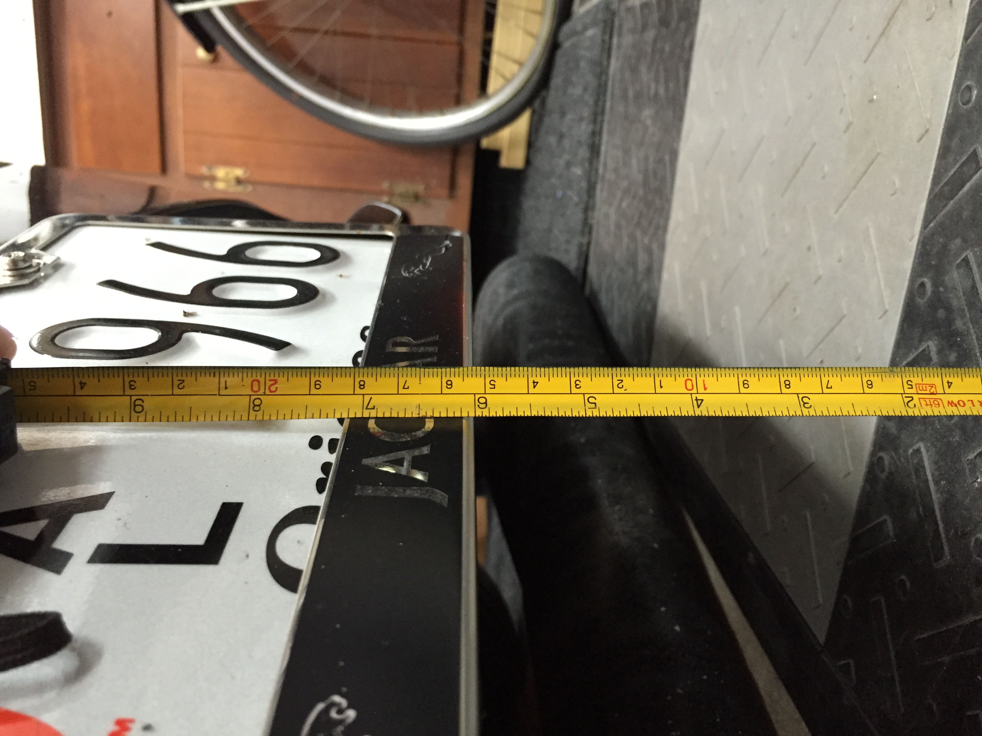

Any problems with scraping it?
I've considered such mountings, but the ground clearance is already pretty small, so I've been leery of trying it.
What's your ground clearance under the nose now?

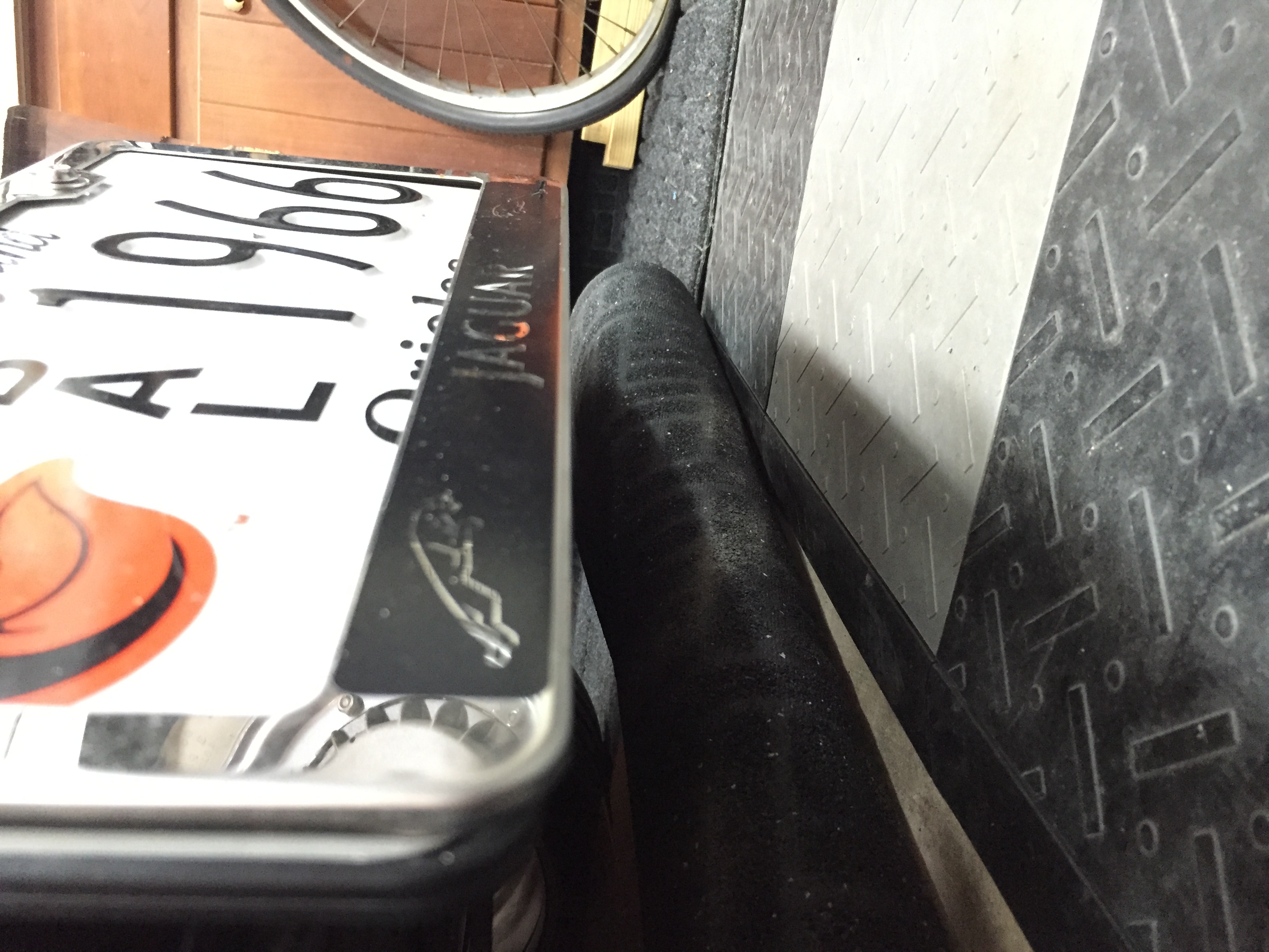

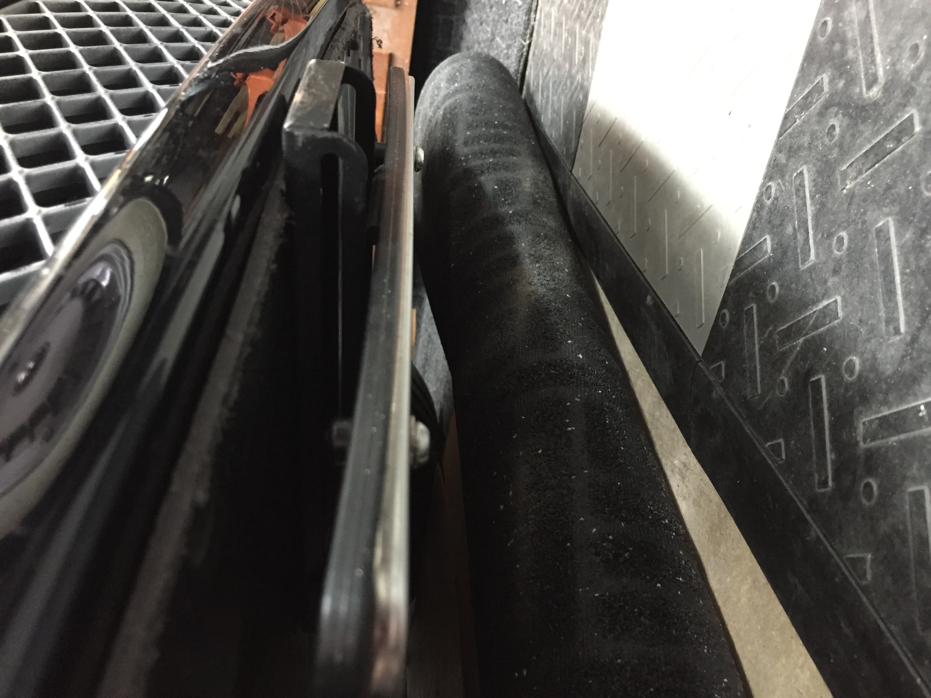

The ground clearance is 6" as shown. With the plate folded (concealed) it's about the same, but then, I do this only when at a cruise'n.
I'm only leery of ground clearance when approaching those cement tire barriers. But then, aren't we all?
Adding this with it's minimal projection is not a deal breaker in my mind. The motorized version may add an additional 1/2", or so though.
