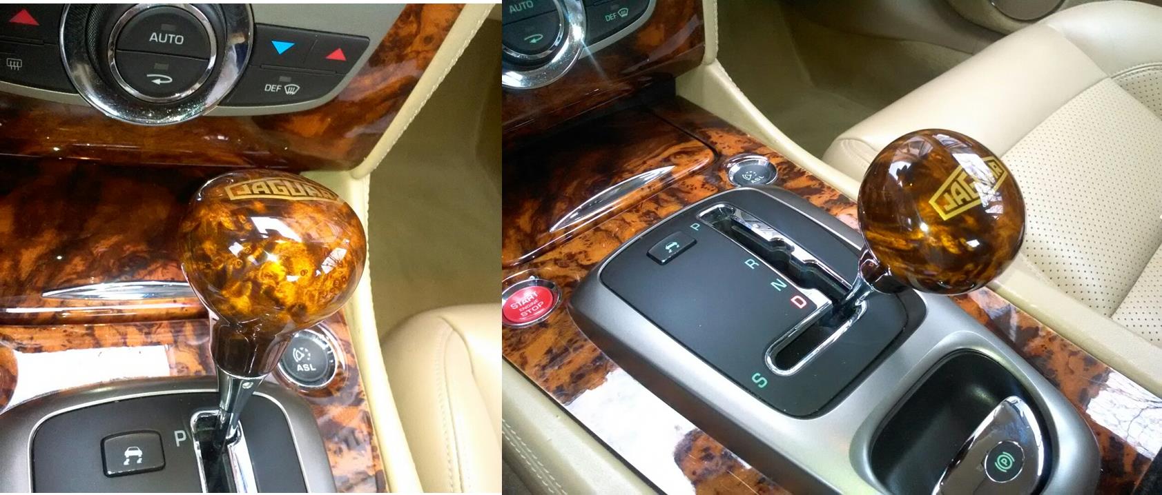

This. British Autowood > Gearknobs
Attached Thumbnails Possible to use a 2012 shifter in a 2008?-136893d1475769182-interior-praise-xk-126018d1456436508-burl-walnut-shift-knob-beautiful-workmans.jpg
