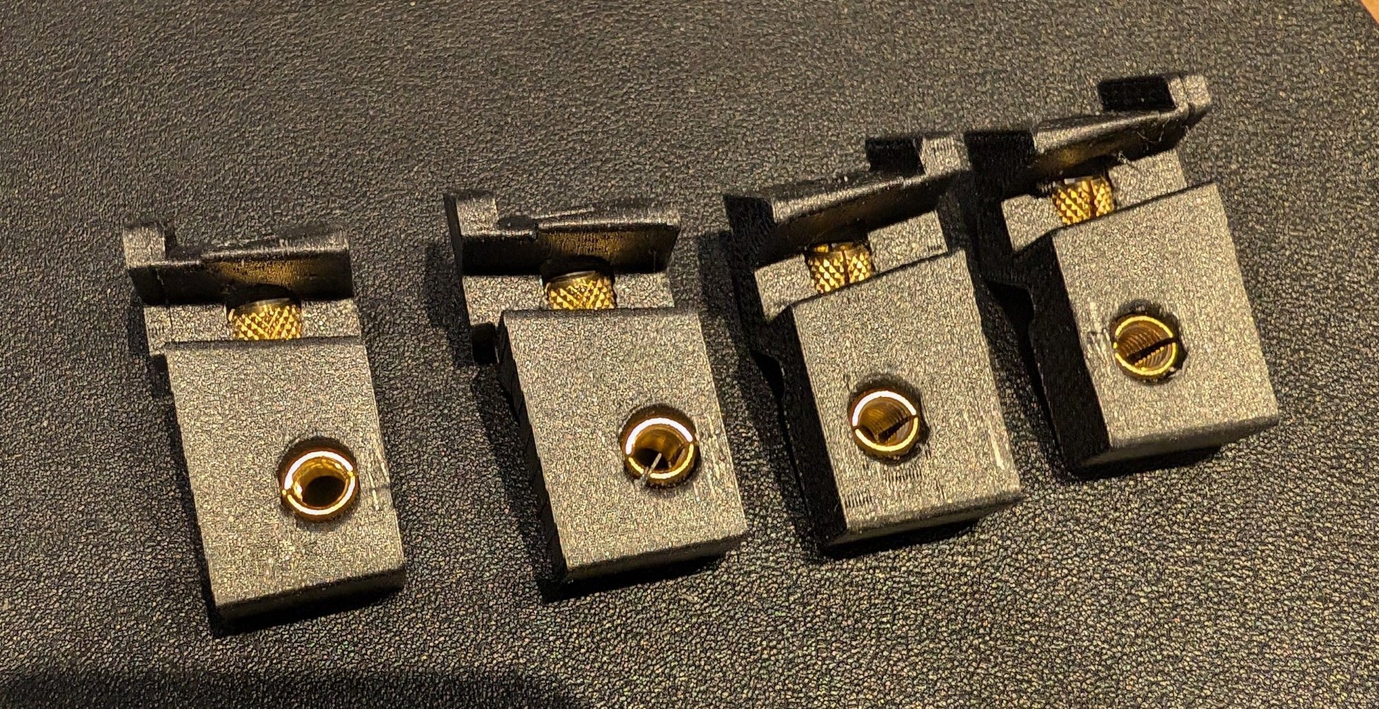

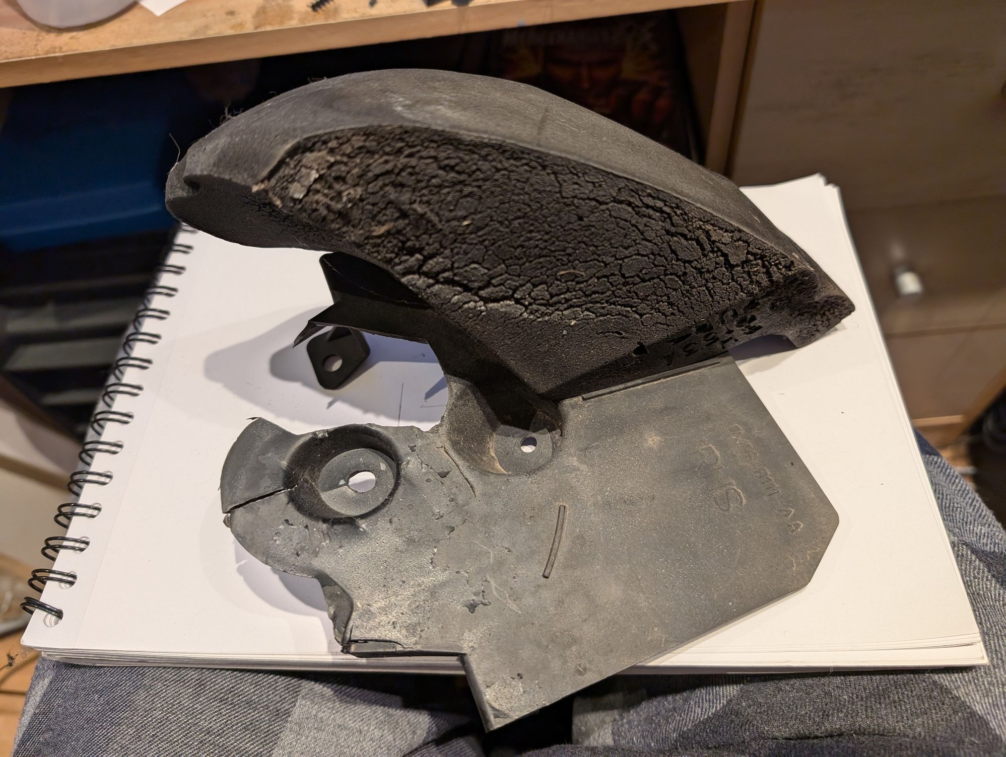

I decided that it was probably best to have a single thread in relation to all the parts I am currently redesigning and upgrading and printing for my car. This is either due to obscelecence and no physical stock anywhere or costing.

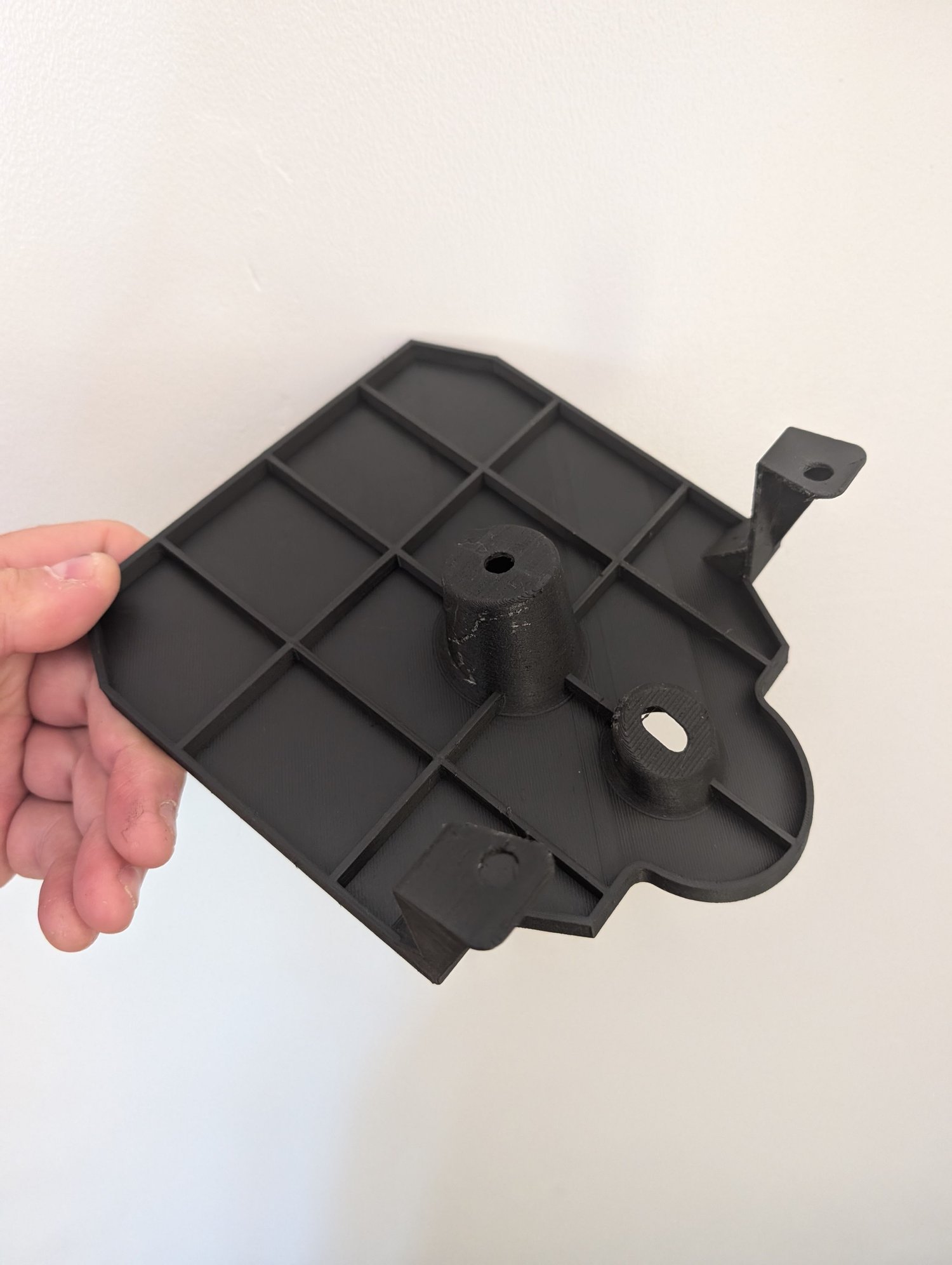

The first item was the bracket for the rear quarter glass to replace the die cast one that breaks. These are made out of carbon fibre reinforced filament with flanged M5 threaded inserts that use the existing bolts.

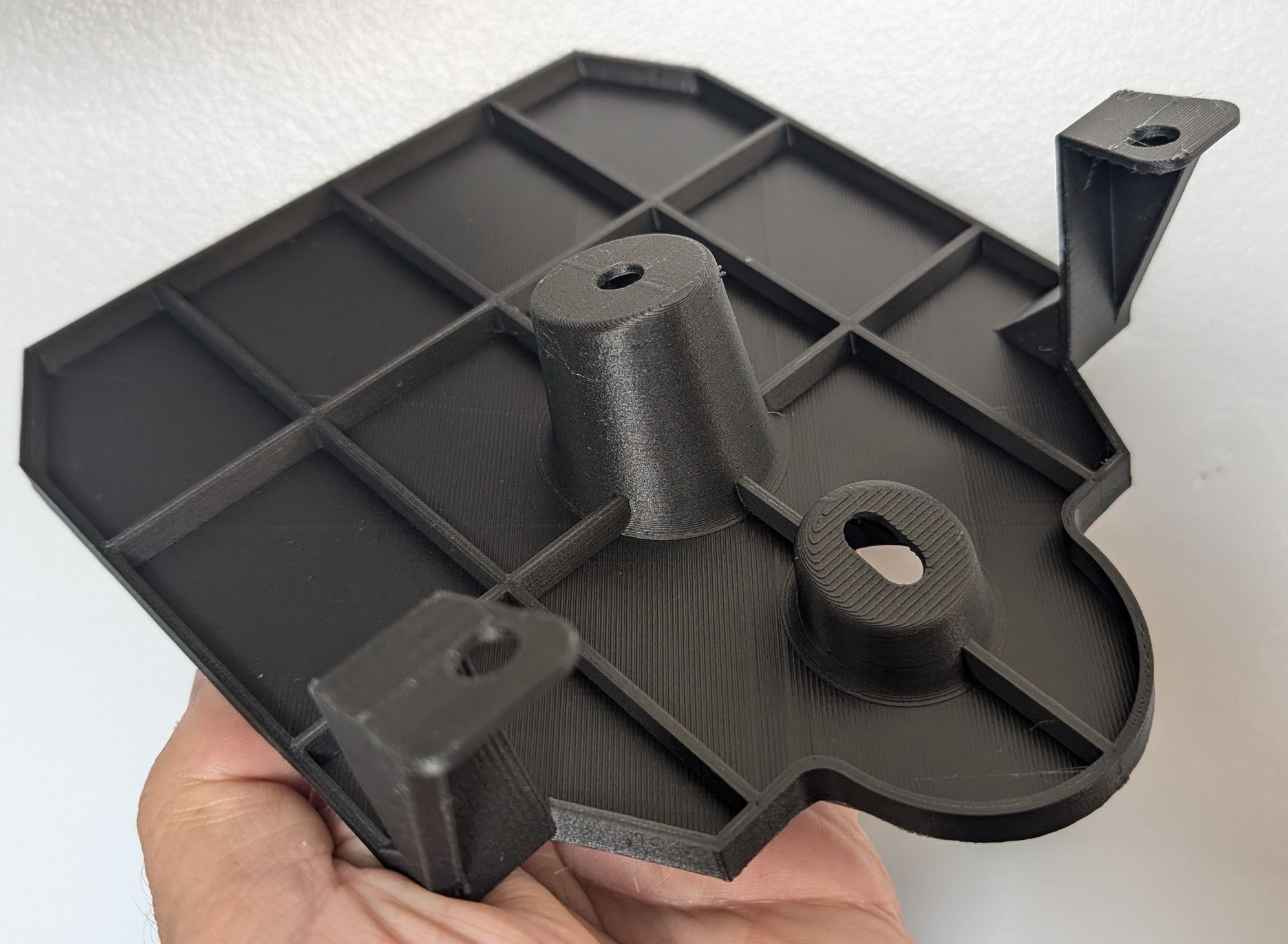

The second is the deflectors that mount underneath the nose cone with handed foam. After printing the final version and the test fit being successful I am now going to run the final set off that will be fitted to the car. These will be out of a carbon fibre reinforced filament also.

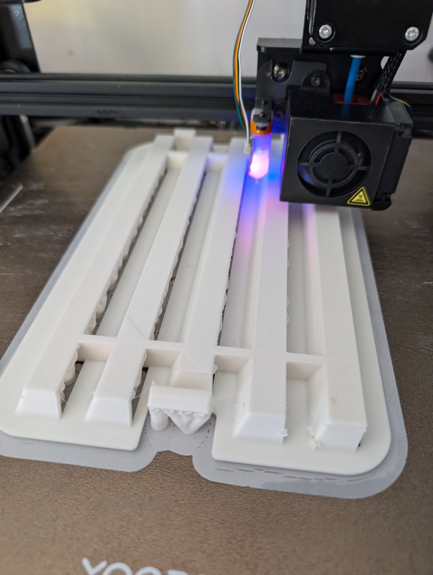

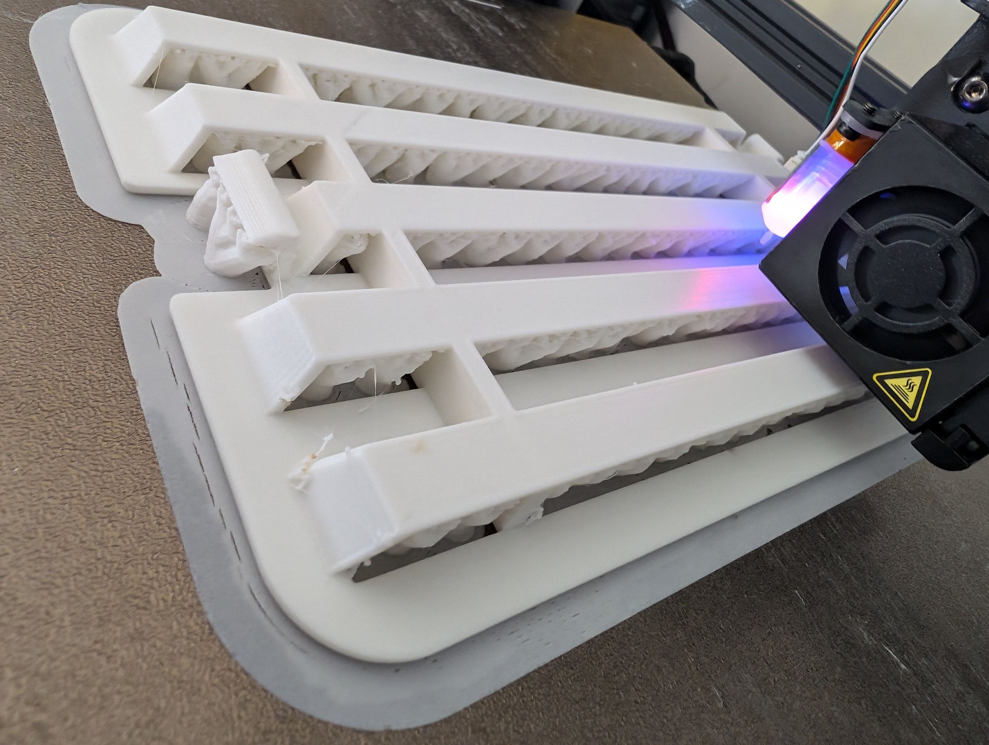

The third part are the inner abs vents that cover the lights access in the trunk. I found them online second hand however, the prices were ridiculous. As one of mine is broken and the other also split I decided to remake them.
The first test print is done and I will check fitment today. I have beefed it up, it's printed in some basic pla filament as it's cheap. The vent will be slimmed down a little to reduce the amount used and also printed out of the matte black carbon fibre reinforced filament.

Rear quarter glass carbon fibre reinforced brackets
Damaged deflector
Damaged deflector
Deflector with foam attached, the foam is handed whereas the bracket fits both left and right sides of the car

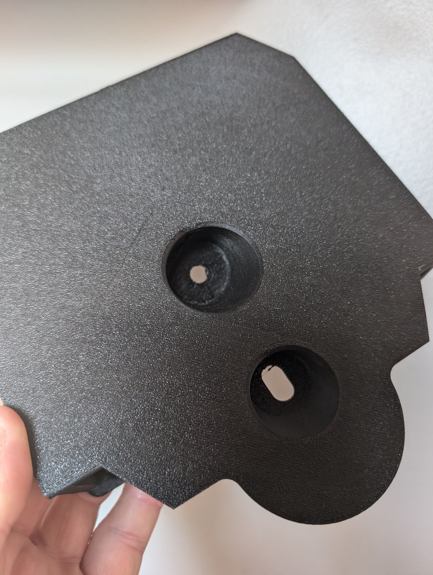

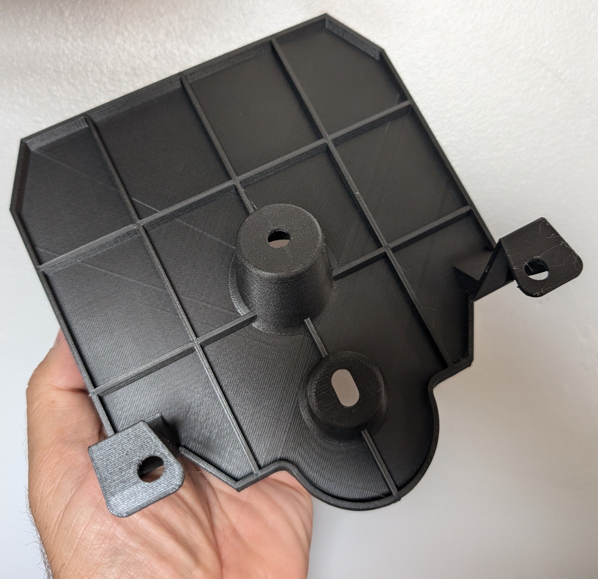

Clean slightly textured surface
First test print of the inner vent for the trunk.

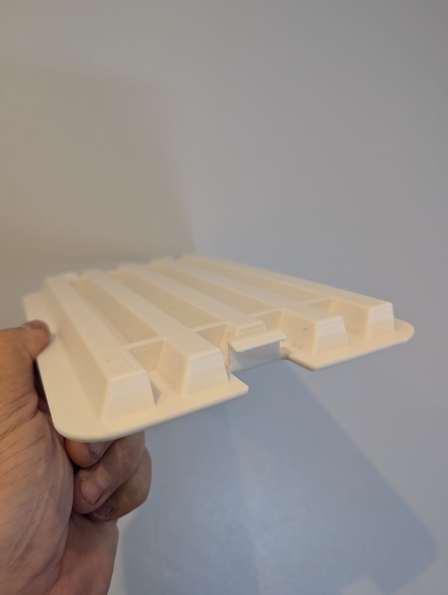

Here is the finished test print of the vent, it's a basic size and fitment check before I refine it. I also am working on a different design of a hex type vent rather than the louvres of the standard one.

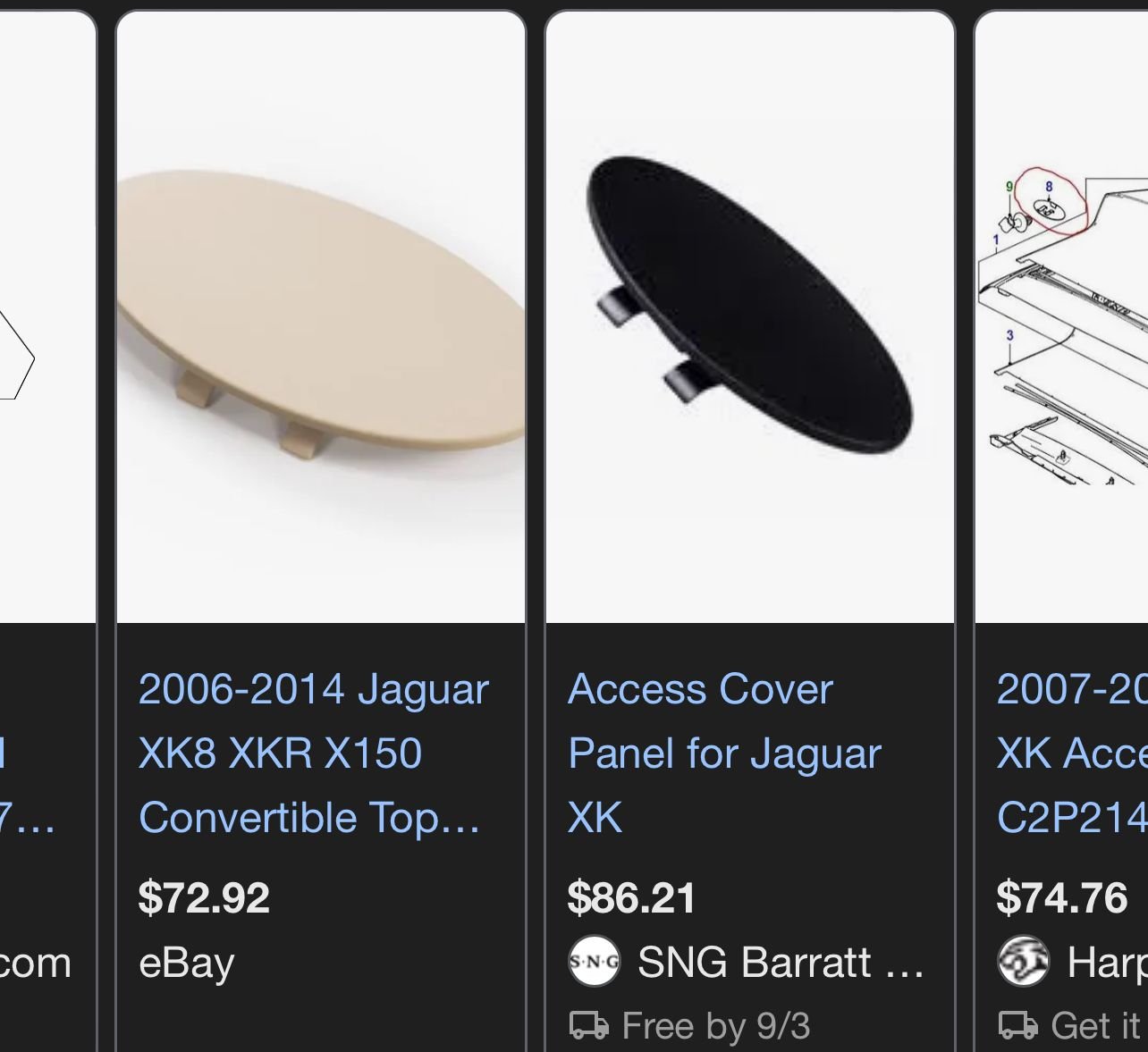

Ill have AI scan the forums for a list of the most commonly broken parts and DM you the list if you’re interested.
You can also scan eBay for overpriced bits of plastic that are no longer available new.
I am missing the Convertible Top Access Cover 2006-2014 and the eBay folks know it is popular and hard to find. So they overprice it.
I luckily found a place in the UK that had a few under $60 all in. But $70-80+ bucks for a used piece of plastic??

I did the test fit of the vent, it all fits but it can be better.
I am going to have a sliding ear on the one side to lock it in place rather than the original hook part. Also extend the two ears that slot in the other side and recess them slightly so the frame sits over the opening on that side.
Other than that it all looked good, just odd in white!!

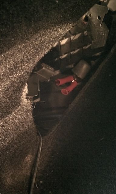

The advantage of the louvres is that you can route a battery maintainer cable through the left one to the charging post, and leave it permanently connected.
Old Aug 26, 2025 | 01:00 PM
Stuart S's Avatar
Posts: 10,116
Likes: 7,123
From: Atlanta suburbs

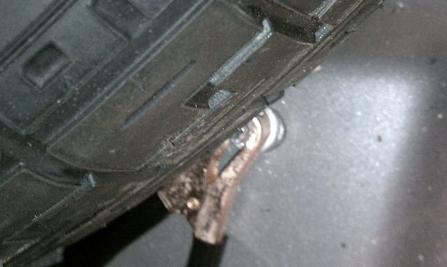

The OEM cover works fine to do that. Here's mine with my CTEK pigtail.
The negative (ground) pigtail runs under the removable floor to the factory provided ground post in the spare tire well.
I've had no problems using the CTEK alligator clips.
