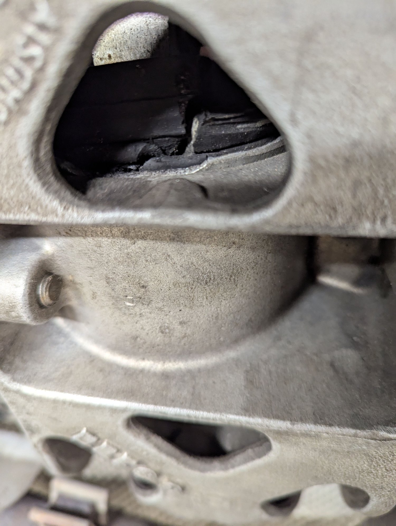

Gear changes have been getting progressively harsher, decided to investigate and noticed a broken gearbox mount p/n: XR849534.
My local JLR dealer quoted me 1400€ for part alone. Not going to happen. Neither will I buy URO parts rubbish from Amazon.
Does anyone know if a similar looking part from a newer XF or F-Pace will fit?

Took a gamble and ordered one for X250.
If it doesn't fit, at least it was cheap. Fingers crossed!

Don't know why, but the part numbers are a mess.
Since I was in a hurry, I ended up getting a used mount from a flood damaged low mileage F-Type. If anyone is interested, part number was C2D38505. Works perfectly, no more clunking when shifting into reverse.

there’s like 1000 variants of trans mounts they all bolt into each other. some are fluid filled some aren’t.
the $80 amazon full set of engine and trans mounts for a 5.0 xf works fine. your engine mounts are definitely broken too if it has more than 50-60k on the clock the emergency strap just stops it from hitting stuff
