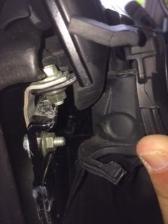

I have a similar problem. Car is at a shop for some cosmetic work including painting the drip rails gloss black. This required removing the quarter glass. However the issue I encountered was with the cast alloy bracket that connects between the L bracket on the window and the body of the car on the RH side, left side was fine. Glass was not loose however I tried to locate the part in EPC as well as the dealer with no success. A call is in to Jaguar corporate hopefully for an answer. Anyone else with this problem have a solution?
The pic below is of the good one.

Bracket I Made after trying Recycle yards and dealers

I need one of these brackets, what did you use to fabricate?

I just used a piece of flat metal drilled2 holes used the broken bracket as a guide then bent in a vise to shape it
