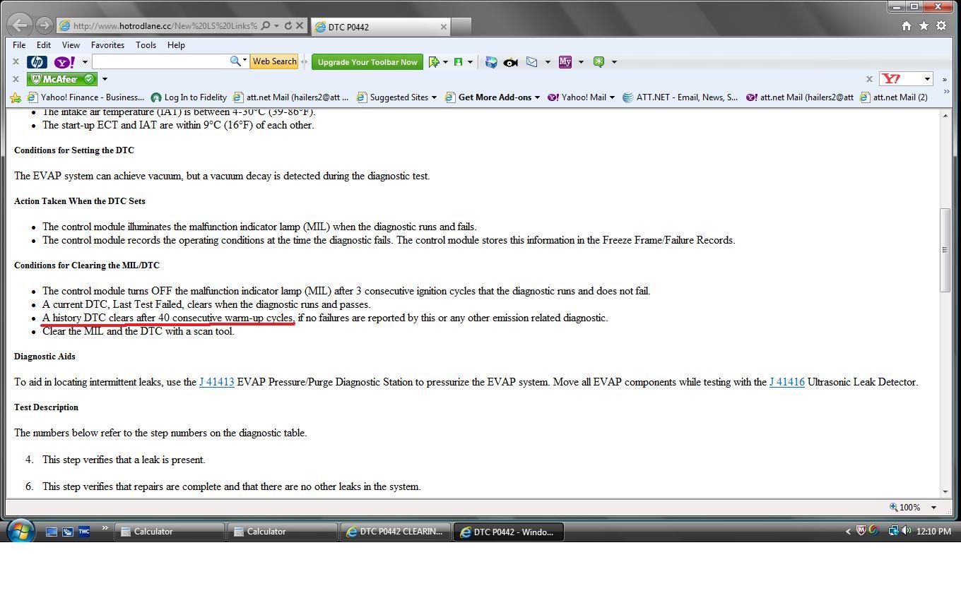

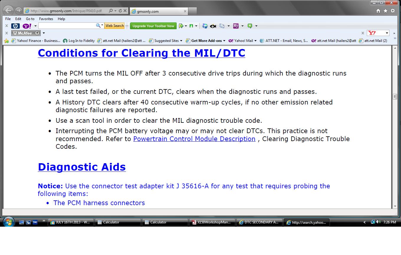

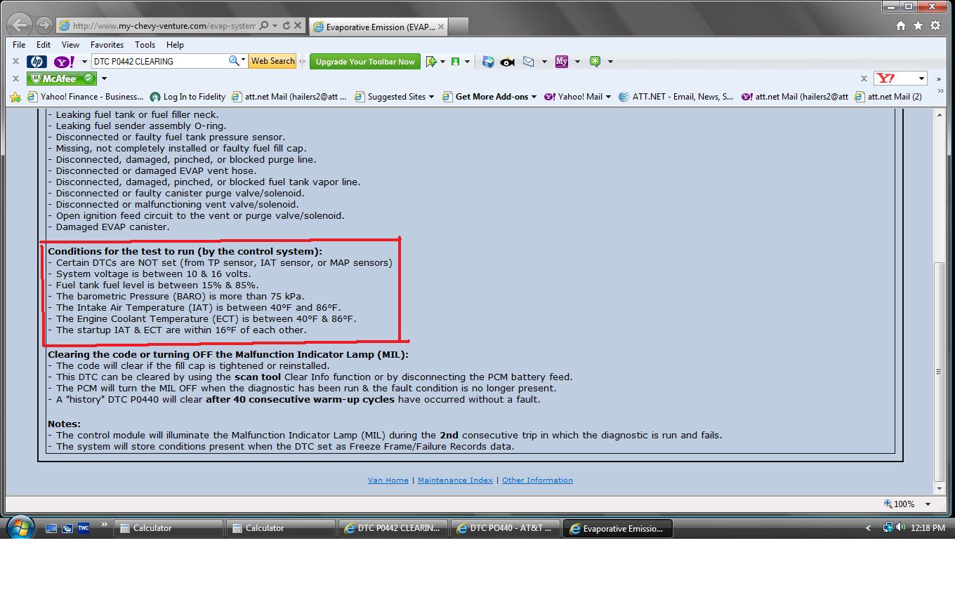

I added three jpgs to this post just for FYI. The FYI is that it is going to be a long time before the Evap Emissions monitor is in the Ready state. Mostly because the criteria for this test done by the ECU, is dependent on the IAT and the ECT temperatures being under 86*F.
This is Texas and it's summer time and I'd be lucky if the temp gets under 86* in the early morning. Any time the air or water temps are over 86*F, the test won't be done by the ECU so just starting the car 40 times in itself isn't going to cut it.
That said, one of the attached jpgs shows criteria for passing the emissons tests in Texas, and it clearly states my 2007 MAY have one monitor in the unready state.
Just FYI and nothing more or less. Not asking questions this time around.

Update: Drove the car early this morning. After the drive all the pending monitors had cleared. Got the emissioins/safety inspection at 11am this morning. Good for another year.
Evidently it does Not take 40 cold engine starts with the IAT/ECT temperatures lower than 86*F to clear a evaporative emissions pending monitor on a '07 XK Jaguar. So much for the validity of my searches for how to clear a Evap Emissions monitor using the world wide net.
