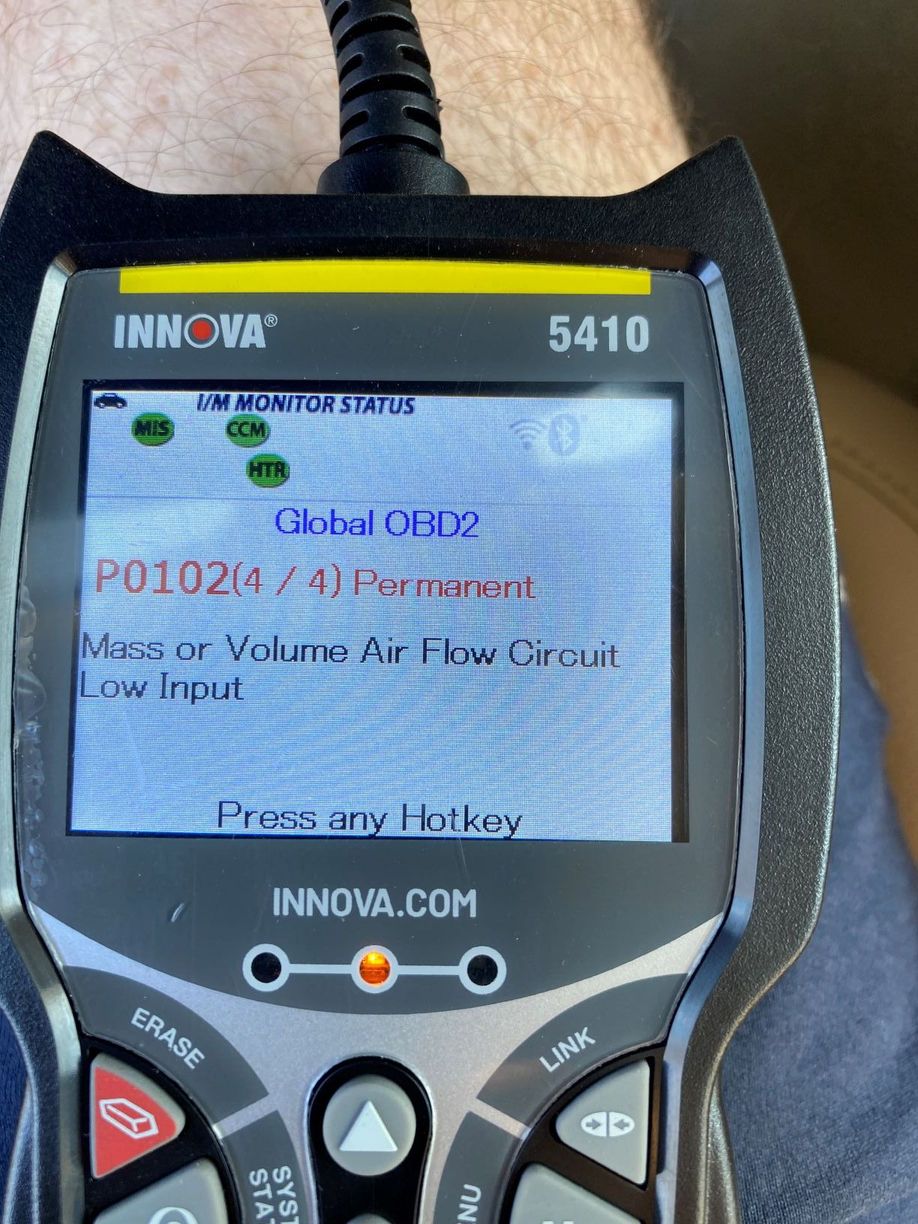

Well this is a pain in the butt.
After replacing all the hoses, pipes and water pump, no leaks, engine runs OK BUT I now have a bunch of unrelated error codes. And a couple of things that worry me.
1) After vacuum filling the system, the reservoir is filled totally to the brim, I expected it to go down a bit once running as the heater core filled etc.
2) The heater does NOT seem to be putting out heat, although it was a hot day (89deg)
3) There are a number of hoses going into the thermostat, a fat hose from under the (new) thermostat going to the side of the radiator is stone cold.
Now, could be I haven't run it enough, but I am reluctant to drive it around the block in case I blow the motor because of some coolant issue because of these suspicious things. Do our cars actually display a temperature warning? I hate not having an engine temperature gauge.

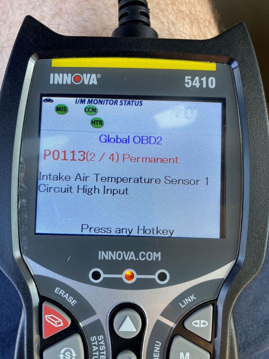

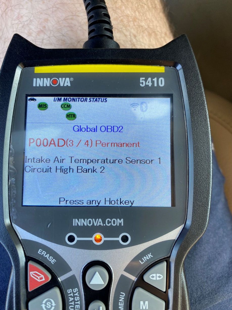

I am getting a boat load of errors relating to mass air flow and air temperature sensors plus the vvt error is still there despite me soldering the wires back to the sensor as shown in a prior thread, and yes, I did check continuity back to the ECU.
Sounds like wiring issues, but I don't see that I broke a wire or left a connector loose.
Now, I have not totally connected up everything just in case there were issues like this, but I have connected the throttle body to the air filter boxes, so air is being drawn across the mass air flow sensors, I didn't know if a false reading would be obtained with no air flowing across them? It didn't seem to help!
Any thoughts?

This could be a false alarm. Turns out "permanent" error codes cannot be reset by an OBD scanner or by disconnecting the battery, they are cleared by the OBD system detecting that the error has gone away which may take up to 15 stop start cycles apparently.
I first fired up the car with the air boxes and thus the air flow sensors disconnected. I fixed the VVT sensor wiring when I did the hoses so that probably hasn't ahd time or sufficient restarts to clear.
All thanks to living in the peoples republic of Kalifornia where they worry about us resetting our DTCs just prior to getting a smog check. I guess the rest of you will get this in due course.
https://www.bar.ca.gov/Industry/Indu...ble_Codes.aspx
