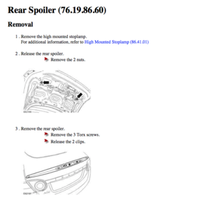

Try this.

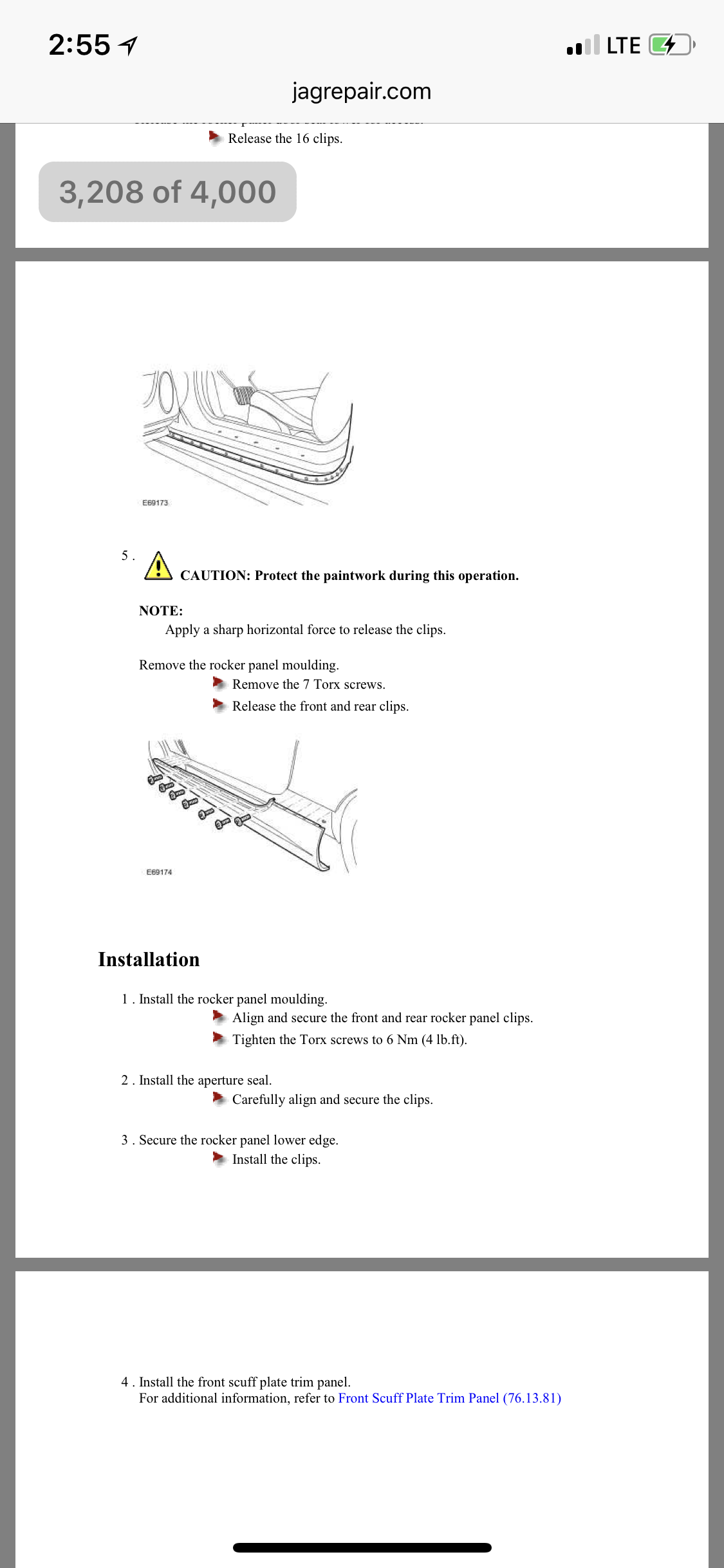

Hey Sean, any chance you have something similar for the rocker panel moldings (part nos. C2P17190XXX and C2P17191XXX)? I have some XKR-S panels coming and would like to see what's involved in swapping them out.

The spoiler actually has 3 screws and two nuts to be removed plus 2 clips on each end. You also must remove the brake light to unplug it and you must unplug the radio antenna located inside the spoiler.
For the rockers there are a number of screw clip fasteners on the underside and screws behind the sill plates.

Here you go:

Thanks guys! Ah another three screws behind the brake light then in addition to the two bolts. I guess a level of pulling to release the clips at each end. Always the worrying bit and nothing much to get hold of! Would a tap from the inside help? They certainly know how to fix things on!!!

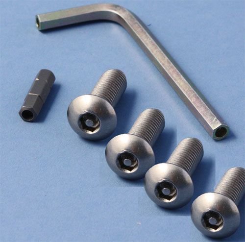

Just fyi, the two screws that held my 3rd brake light on were tamper proof hex key screws.... Not sure if yours will be or not...
example below:

Odd that they even make those since you can buy the damn wrenches right next to the screws. Should call them something different than tamper proof. Maybe "unnecessarily inconvenient screws".

Note when removing the sill plates that you must remove the glued on aluminum trim to get to the bolts. Use a heat gun to soften the glue and try to get the aluminum trim off without bending it.

As you say, what's the point and you couldn't steal the spoiler as there are two more bolts from the inside out. I haven't got that wrench so have to buy one now!
