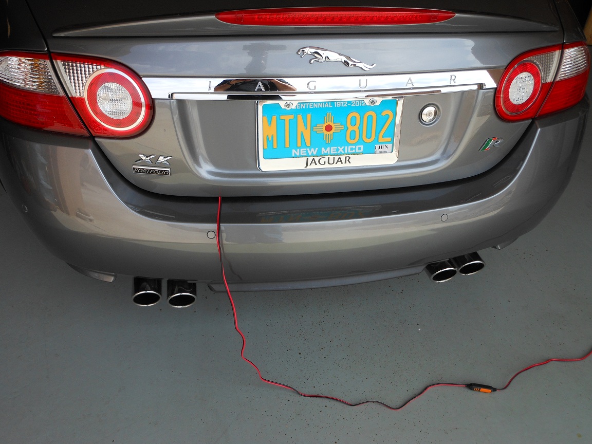

You need to buy a CTEK 3000 trickle charger and keep this connected to your Jaguar battery all the time. Just unplug the connection from charger to car when you are ready to drive away. Your battery will be always fully charged. The Jags use allot of battery power. Many of us Jaguar owners own this brand of charger and they work well.
Also be sure to lock your car at all times, as the electronic sysytems in the Jaguar will remain drawing power up to as long as 36 minutes. These premium cars with allot of electronics draw a huge amount of power from the car battery.
Just google: CTEK 3300 or go to Amazon.com
I use the CTEK 3300 on both my 2009 Jaguar XKR and 2014 Porsche 981. I never have any more concerns over weak or dead batteries.
It's a cheap investment of $65.00 or less and ends frustration.
