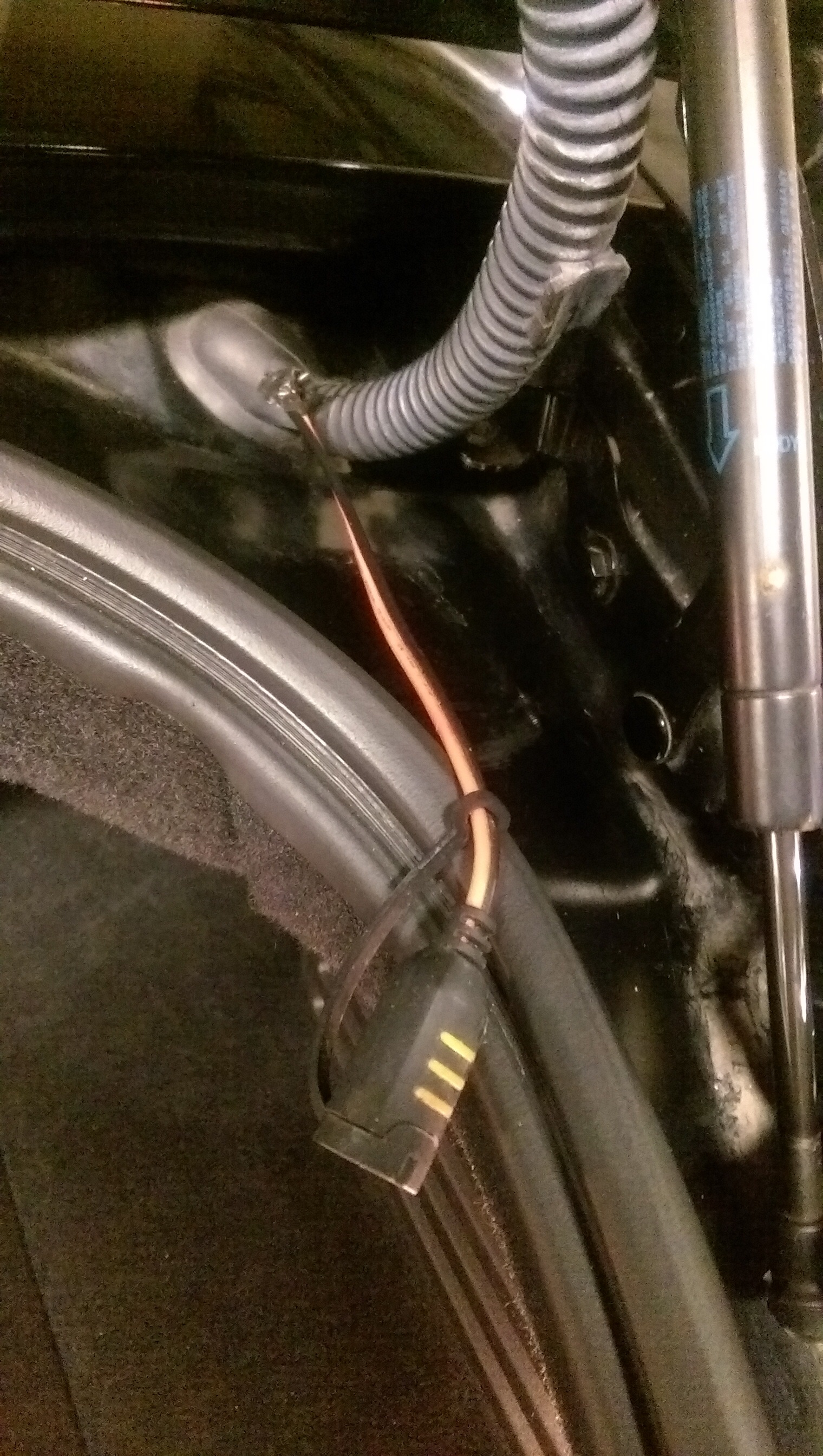

Hi all, just bought a Jag XKR 2010 and am loving it so far!
I see a cable coming out of the trunk, but it is not mentioned in the manual. I've tried taking it back by removing the battery compartment cover, but it does directly connect to the battery.
Couldn't trace it fully without removing more of the inside boot lining, but before I do I wanted to know if anyone came across this?
Does anyone know what it could be from the pic? My initial guess was a leftover trickle charger cable?
Thanks!

That is a connector for a CTEK battery charger/maintainer, which everyone here will tell you is something between a wise investment and an absolute necessity.

+1. There are many threads about the CTEK brand of battery maintainers. They're available on Amazon and are highly recommended since our XKRs are very sensitive to weak batteries. I prevent electrical gremlins by keeping my Jags on battery maintainers. The latest model is the CTEK MUS 4.3 but many forum members have the 3300, which is the same as the Jaguar branded accessory sold by your dealer's parts department for a lot more than on Amazon. Obviously, the previous owner forgot to remove that pigtail when he sold the car. That pigtail fits both of the above mentioned models.

Yes, it appears you have the remnants of a trickle charger. Now, as mentioned, make use of it.

Looks like you have the CTEK extension or the CTEK connector is already connected to the battery posts.

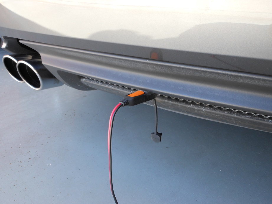

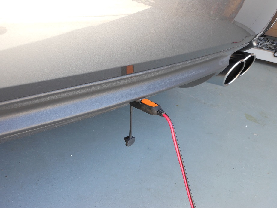

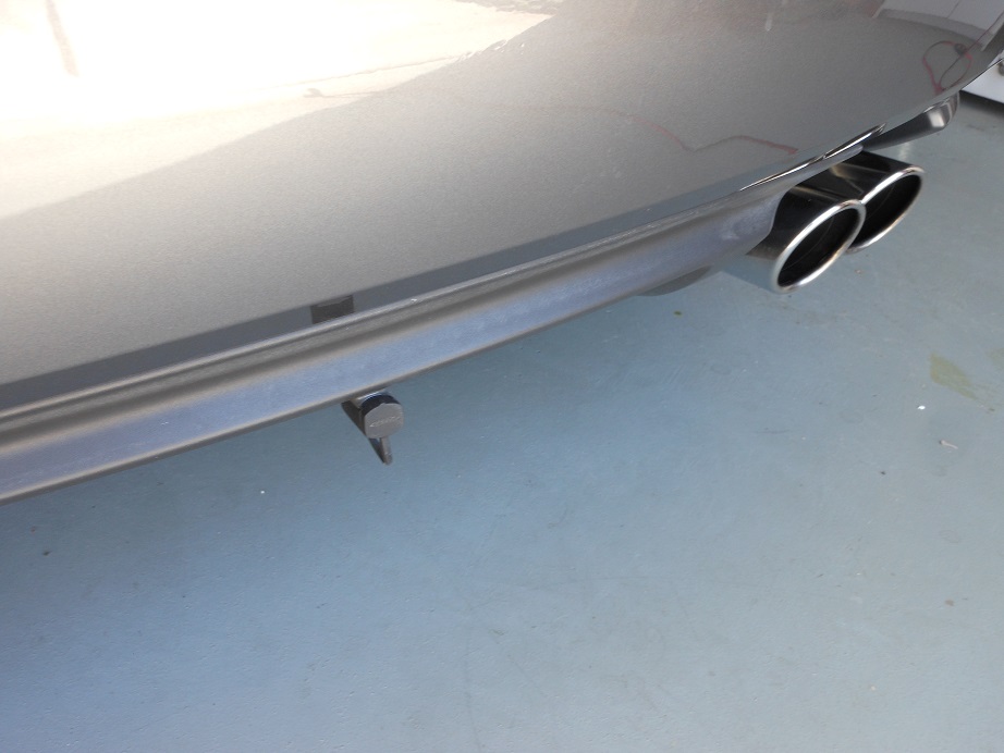

Here's my setup on my CTEK......with this setup there is no need to open the trunk lid to make the connection.
I simply plug into the connector and it takes about 3 secs. Whenever the XKR is pulled into the garage the CTEK always gets connected.
Also in your photo it looks like the CTEK is being jumped within the wiring cable. You need to make sure it is not spliced into a power wire. It needs to go directly to the battery terminal on the positive (red wire from CTEK) and the black CTEK wire to a ground (Negative) since you have a 2010 MY Jaguar.
