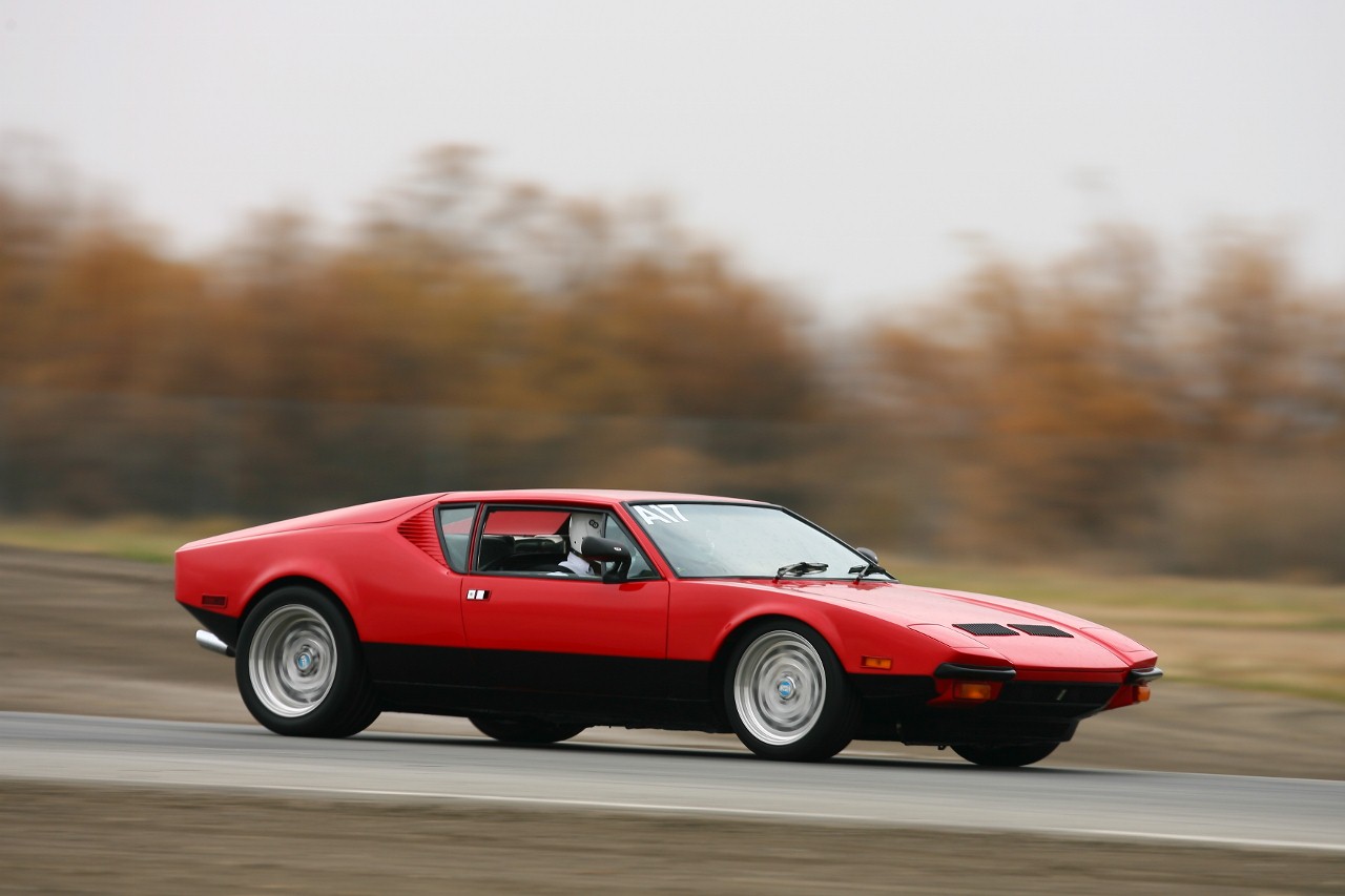

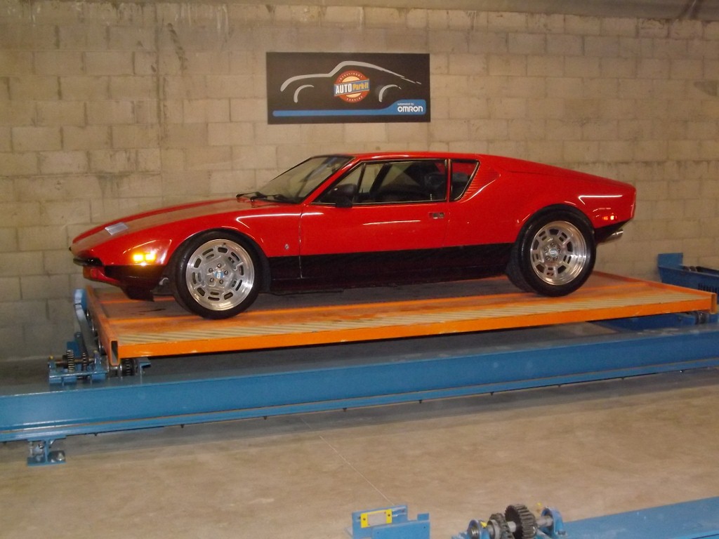

Peter,
When I bought the Pantera years ago, the first thing I did was upgrade the brakes to Wilwoods. But, of course, once you do that, you can't fit the 15" Campys back on the car so you have to go to 17." I put the Fluidyne radiator in since I could barely drive the car two blocks without it wanting to overheat, and certainly never in traffic. Now, it has been in the shop getting a "new" built 351C, additional sucker fans, and the Holley fuel injection system that looks like the carburator it's replacing. I'm upgrading a few things, and even though the paint was in very good condition, we've already repainted her. The new engine will be about 500hp on a less than a 3000lb. car so there should be a lot of fun in my future. I see you spend time in San Diego, when I get the car back (hopefully) in a couple of months, why don't you come up and take it for a day. Sure it's "ancient" compared to modern day supercars, but it's certainly more beautiful than any of the offerings from Lambo, Audi, etc. I used to take it to the track a couple of times a year with SoCal Audi Club (a friend is president) and it always garnered more attention than the R-8s. Sorry to have hijacked the post.

Peter,
and don't think for one second...the boxer paint was lost one me
seriously, a great looking pantera. I am a purist but I must say that your car does not take any indecent liberties while doing some very tasteful mods. a very pretty small bumper car...a delicate BEAST!
I am in LA often. It would be great to meet for coffee and talk cars. By the way, the Coronado vintage cars races are this weekend. a large pantera presence but nothing as well executed as yours save for one or two bone stock originals...which to some may be as nice but by all means cars I would walk past on the way to see your panther!
