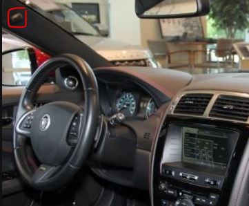

I thought it was this thing on the A pillar, what is that then?

I was testing that yesterday and stuck my finger over it while I was talking but it made no difference in sound for my wife. But then I stuck my finger over the thing in the roof cluster too, and that didn't change either. And the little plastic thing in the fascia under the instrument cluster. I've been putting my finger everywhere, and none the wiser :-(
Correct....same as 2009 XKR.
I've always think it was that on pilar A. Actually, I'm quite sure it is that..
Schwabe, I believe the item you show is the "TSB Repair, where they relocate the mic from behind the pillar to outside the pillar...

The A-pillar...I thought I was the only one who really had no idea what that thing was. This makes me feel better. Really do not understand the design here though other than directly (sort of) to the driver but that is always assuming the driver is the one talking. As mentioned here, previous cars have always been in the center upper console which seems like the logical spot. A-pillar is fine but why not something a bit more flush mount?

I really should read more but I hate to read! Checked my manual and here is what it states:
"....and a dedicated microphone is fitted behind the A pillar trim on the drivers side."
